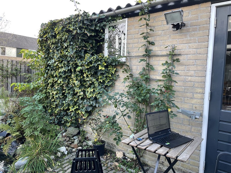

To make a first test measurement, I placed both the ZMOD4510 and HS4001 sensors outside, making sure that they were in a shadow, so not influenced by the direct sunlight.
image  image
Yes...I have to clean my garden a little bit! Smiley
First of all, I used the temperature and humidity sensor, because I also needed these data to properly set the OAQ algorithm for the air quality sensor.
The measure took 4-5 minutes to be stable, probably because the sensor was inside my house before this measure. As you can see from the plot, the relative humidity sensor is slower, compared to the temperature.
When the sensor will be stable outside, in my "Environmental Station", in a proper ventilated enclosure, it won't require too much time to provide a stable measure in every cycle, I guess.

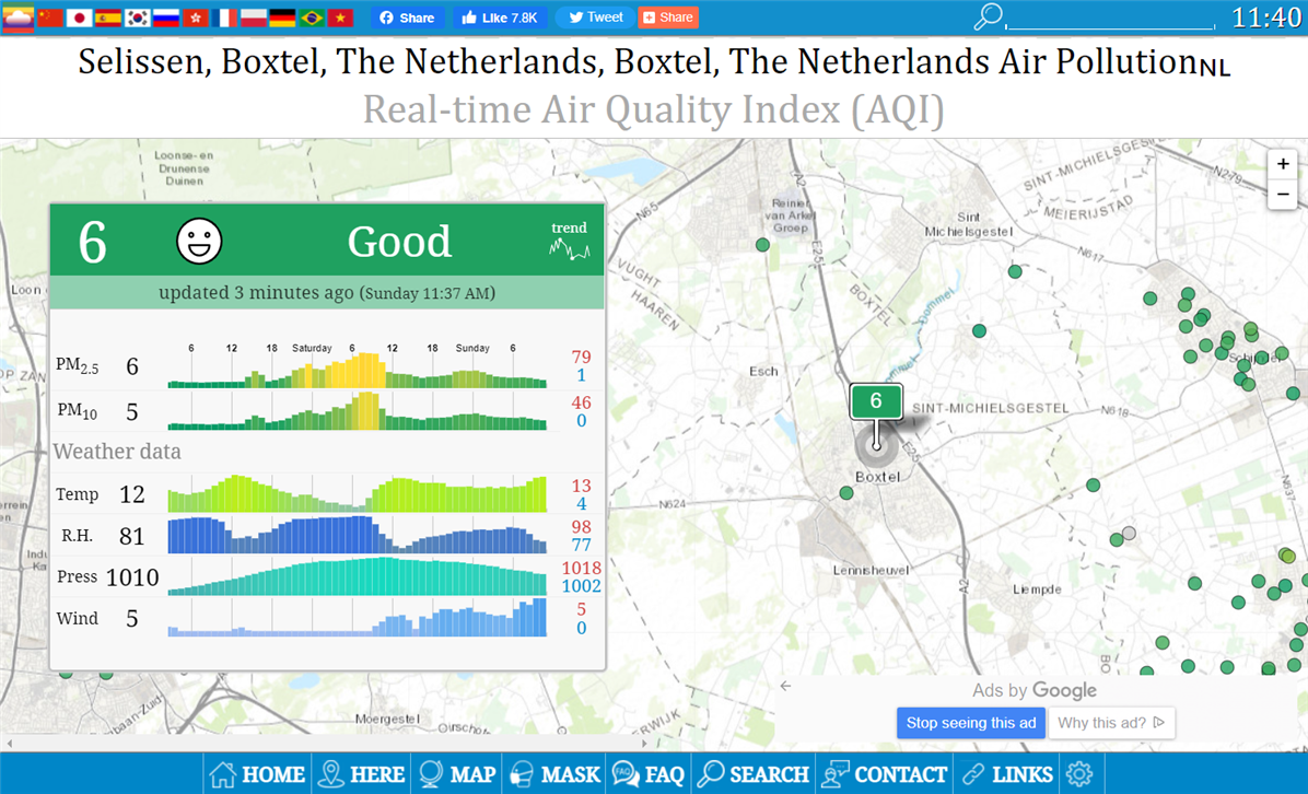

Air quality index comparison with existing local data
To validate the registered data, it's useful to compare it with local data, easy accessible from the web. There are 2 stations within my area (near Eindhoven, Netherlands) from which I can get comparable data. These two stations are not so far from my house, so I can expect that the NO2 and O3 levels will be not so different from my garden.
These data come from https://aqicn.org/ network and they seems pretty aligned my measured AQI, even if in this case the AQI calculation is based on PM2.5 and PM10, not on NO2 and O3 levels.
