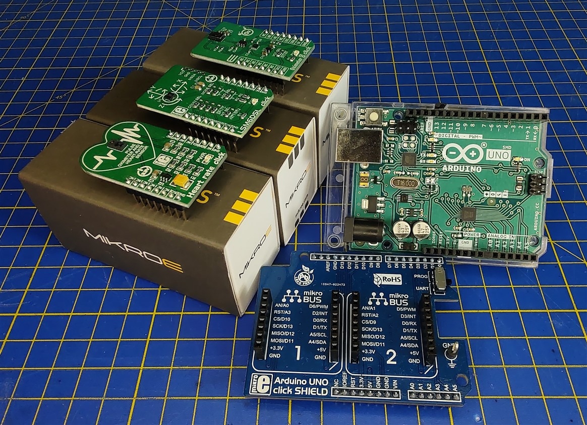

I'll begin this section by thanking the judges again for being selected as one of the challengers who received this starter kit. This is a great kit, with many components that will be useful for this project. The starter kit consists of 5 items:
  1. Arduino Uno
  2. Arduino Uno Click Shield
  3. MikroE Heart rate click
  4. LSM6DSL click
  5. Oximeter 5 click
The kit contains the microcontroller which will be the main component of this project around which everything else will be implemented, the Arduino Uno. Besides that, we have a shield for the Arduino Uno that will enable us to easily connect the click boards to the Arduino as well as a few click boards that we can use for this project. Below you can check the relevant links and information for all of the pieces of the starter kit.

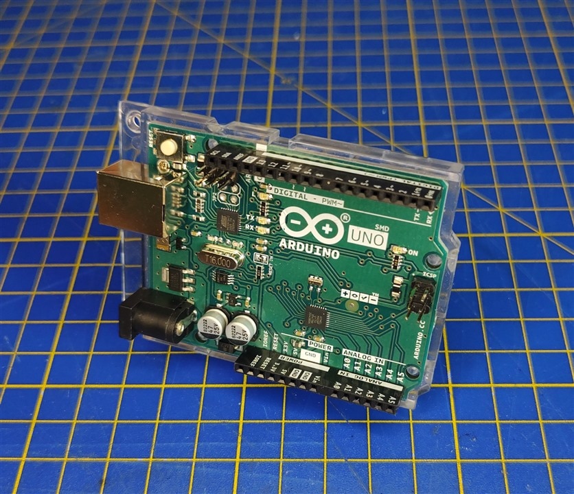

Arduino Uno
As mentioned above, this is the main component of the whole project around which we need to configure everything. This is by far the most famous and most recognizable Arduino (and microcontroller board) out there, the Arduino Uno.
The Arduino Uno comes with an ATmega328P microcontroller onboard, with 14 digital and 6 analog pins. The UNO variant of the Arduino came out over 12 years ago.
Relevant links:
  • https://store.arduino.cc/products/arduino-uno-rev3-smd
  • https://www.arduino.cc/en/Guide
  • https://export.farnell.com/arduino/a000073/arduino-uno-smd-dev-kit/dp/2285200

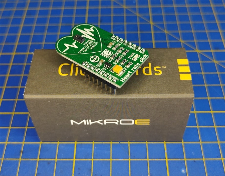

Heart Rate Click
Heart Rate click is a heart rate monitoring and pulse oximetry measuring Click board. It features an advanced oximeter and heart rate monitoring sensor, which relies on two integrated LEDs, a photosensitive element, and a very accurate and advanced low-noise analog front end, to provide clean and accurate readings.
The easiest way to connect to it is using the Arduino Uno Click shield, but we can also connect it to the power and to the I2C bus since that is how it communicated with the microcontroller.
Relevant links:
  • https://www.mikroe.com/heart-rate-click
  • https://export.farnell.com/mikroelektronika/mikroe-2000/heart-rate-click-easyboard-dev/dp/2786878

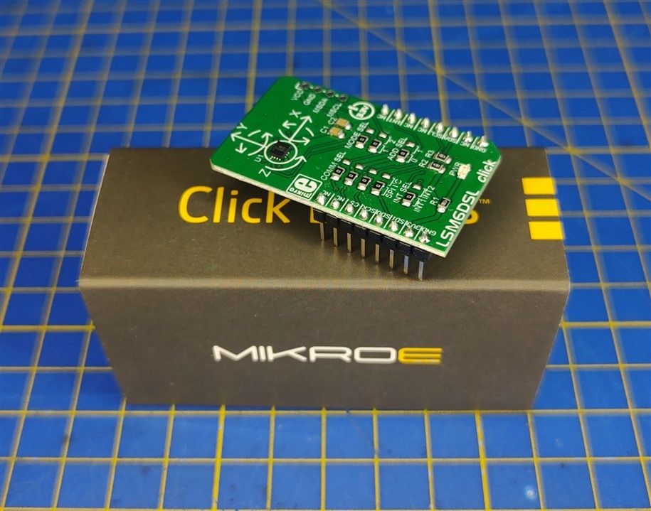

LSM6DSL Click
The last item from the starter kit is the LSM6DSL click. This click board measures linear and angular velocity with six degrees of freedom. It carries the LSM6DSL high-performance 3-axis digital accelerometer and 3-axis digital gyroscope.
Relevant links:
  • https://www.mikroe.com/lsm6dsl-click

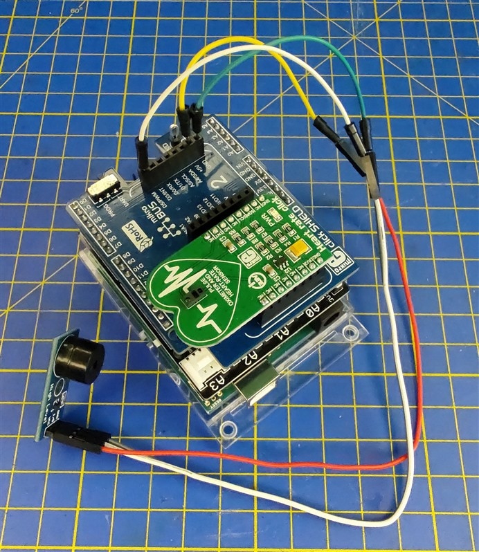

If you try looking for irregularities only by looking at the icon in the video, you will see that it's really not that easy to see what's going on. Below, you can see my experimental setup using the components from the starter kit, for the test I went with the Heart rate Click board.
I've connected the Arduino Uno and the Click shield with the heart rate sensor, and I've also connected a small 5V buzzer module which is activated for 50ms every time a heartbeat is detected. In the video below, you can see this setup in action.
The buzzer can be heard much more easily than the one on the blood pressure monitor, and it's much easier to tell if there are any irregularities from listening rather than looking at a small icon as I think the two videos above showcase pretty well.
