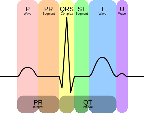

Understanding the ECG Signal
The digital value when plotted in a graph will show a pattern of repetition, hereinafter known as a PQRST signal in the medical terms.  Signals from those three electrodes will produce a graph that has hills and valleys as a representation of the heart's electricity.
The Electrocardiogram (ECG) signal is considered to provide valuable information about cardiac diseases. Therefore, accurate identification of the properties of an ECG signal will help detect abnormalities within the signal and improve predictions. The ECG signal records the electric pulses of the heart, including the magnitude and direction of the signal. Electrical flow is produced by the depolarization and repolarization of the atria and ventricles. A typical ECG signal cycle contains three waves, namely, the P wave, the QRS wave, and the T wave, as shown in following figure.
Additionally, the ECG signal contains several intervals, such as the PR, QT, ST, TQ, QRS, and RR intervals shown in the above image. The shape and amplitude of the waves and the duration of the intervals determine the characteristics of the signal and whether it is normal or abnormal. Moreover, these characteristics can be used for diagnostic purposes. For example, a normal P wave should be present and upright, so an absent or inverted P wave may indicate that the patient has a form of dysrhythmia such as junctional rhythm. The PR interval should be between 0.12 and 0.2 s, and therefore, detection of it outside its normal time range can indicate hard line dysrhythmia. The QRS complex is usually between 0.06 and 0.12 s, so a duration above this range can indicate Premature Ventricular Contractions (PVC) dysrhythmia. Unequal RR intervals in an ECG signal indicate that the rhythm is irregular. Furthermore, an ECG signal can be utilized to calculate the heart rate. Accurate analysis of the ECG signal is essential for both specialists and patients.
