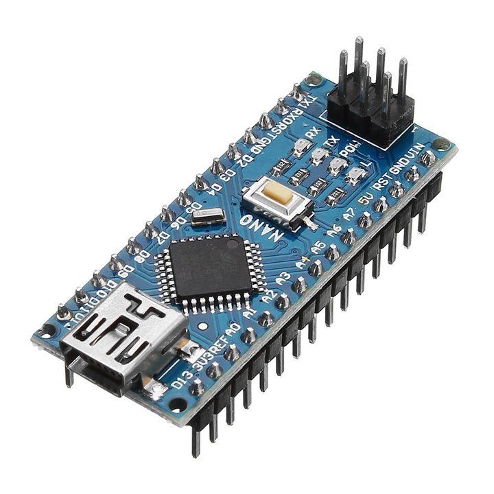

Arduino Nano
The Arduino Nano is the brain of this unit. It collects the data from the sensor, displays the useful information to the display, and sends the data to the main unit through Bluetooth. The reason for using the Arduino Nano here is its small form factor. As this is a wearable unit the size should be as small as possible.

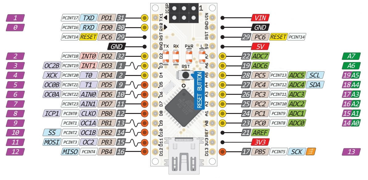

Arduino Nano Pinout
Arduino Nano Official Link: https://store.arduino.cc/products/arduino-nano

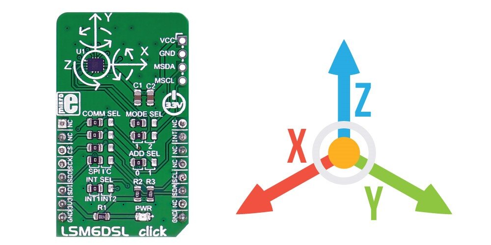

LSM6DSL
This component is another important element of the project. This is a high-performance 3-axis digital accelerometer and 3-axis digital gyroscope from MikroElektronika. The click is designed to run on a 3.3V power supply. LSM6DSL click communicates with the target microcontroller over SPI or I2C interface. I used this sensor here for activity detection, fall detection, and sleep tracking. Details of the sensor and its working was discussed in my previous blog.
Official link: https://www.mikroe.com/lsm6dsl-click

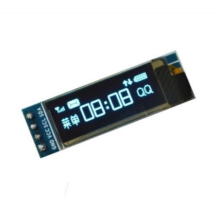

128x32 OLED Display
These displays are small, only about 1" diagonal, but very readable due to the high contrast of an OLED display. This display is made of 128x32 individual white OLED pixels, each one is turned on or off by the controller chip. Because the display makes its own light, no backlight is required. This reduces the power required to run the OLED and is a perfect choice for the wearable devices. The driver chip of the display is SSD1306 and it communicates via I2C only.
Details of the display: https://www.adafruit.com/product/931

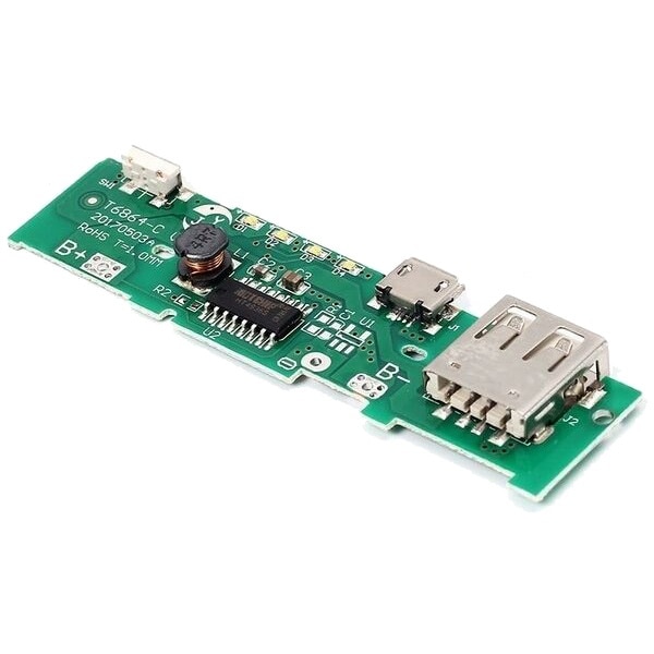

Power Bank Circuit
This power bank charger circuit has an integrated battery charger and a 5V boost converter. So, it is serving both the purposes required for our system.

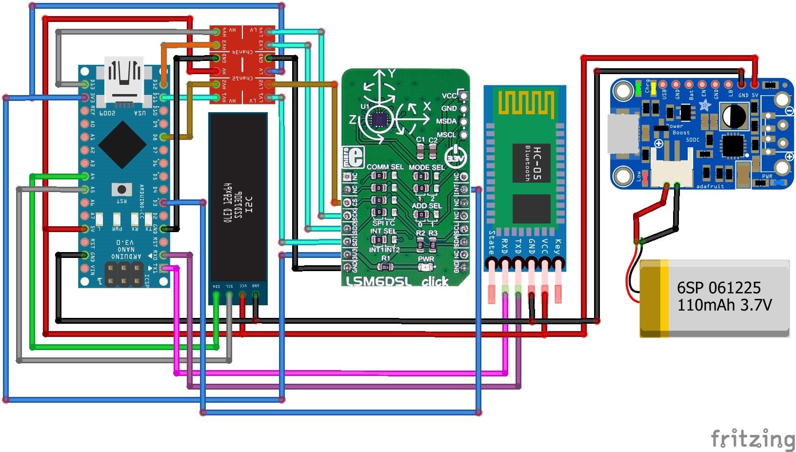

The Schematic
Here is the Fritzing schematic for the wearable unit of the remote patient monitoring system.
