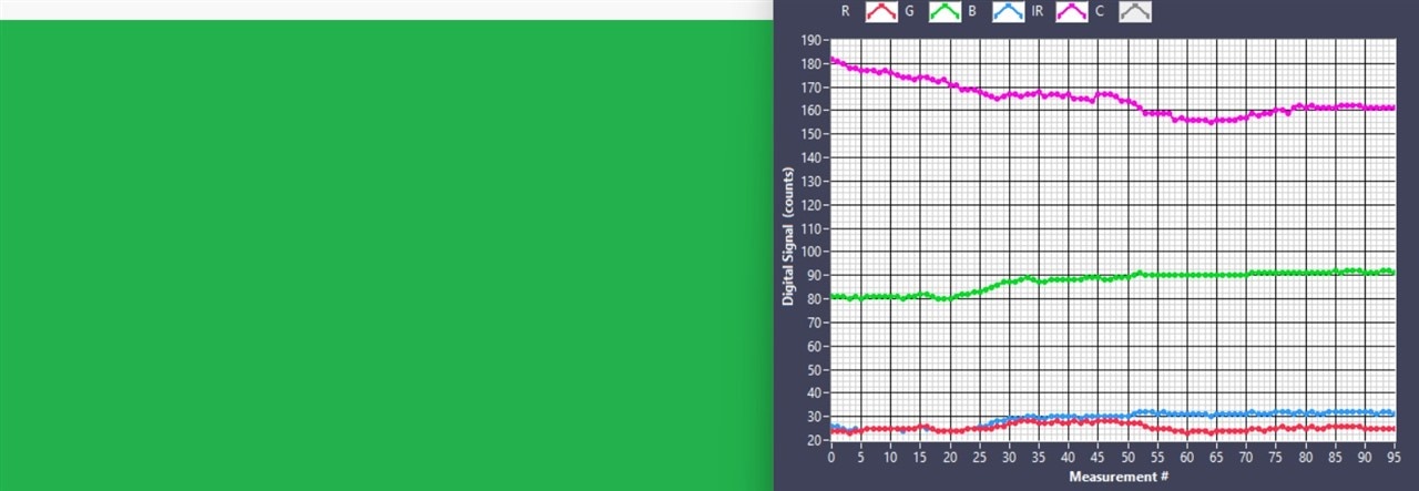

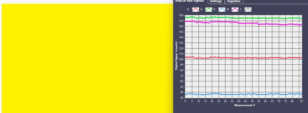

I was able to find a set up guide for the SensorXplorer board, that I ran through to get the board ready. Once all the proper software was installed to interface with the board, I could get raw readings from the color and proximity boards. Here are the readings I got with each color:
The red, green, and blue readings act as I expected them to, with each respective color much higher above the other two. Another interesting thing is the scale the colors levels are in changes, so instead of having a set limit to tell what colors are high and which are low, I will have an algorithm to tell which level is the highest and whether there are any near enough to be counted as high as well.

    DeltaPi over 4 years ago in reply to DeltaPi
    I don't know how much the color readings will change, but there can be quite a difference between the subtractive and additive color wheels.
  • DeltaPi
    DeltaPi over 4 years ago in reply to baldengineer
    Good Idea, I was using an LCD screen. I should try with a piece of colored paper to see how that changes the color.
  • baldengineer
    baldengineer over 4 years ago
    Just curious, did you perform that test by pointing the sensor at an LCD? Or did you print them out on paper?
    I'm curious how emissive vs. reflective light/color would be detected.
