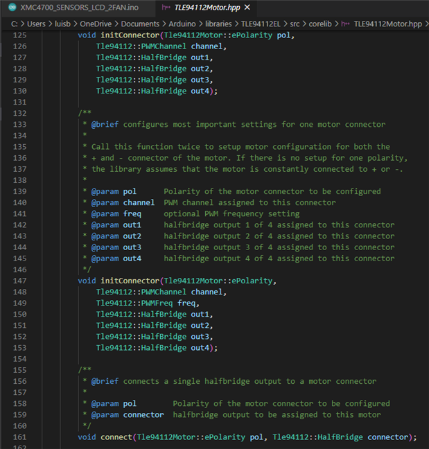

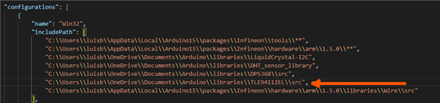

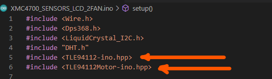

Add the libraries and paths
We made sure to read the library documentation carefully (that's why I prefer to use VSC)

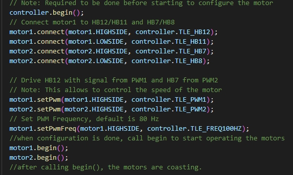

And we configure our motors on outputs 7/8 and 11/12, which are the ones we are going to use for the water pump and the gas extractor.
