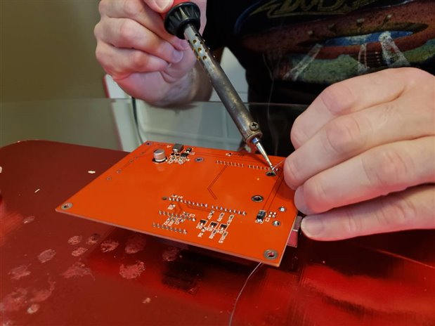

Wow, where did all the time go.  It seemed to evaporate.  I tried to stay disciplined with my time management but sometimes life gets in the way.
I woke up on Saturday morning with the realization that a whole lot of work still needed to be done.
After my coffee I crouched over my kitchen table to solder the remaining components on the carrier board.

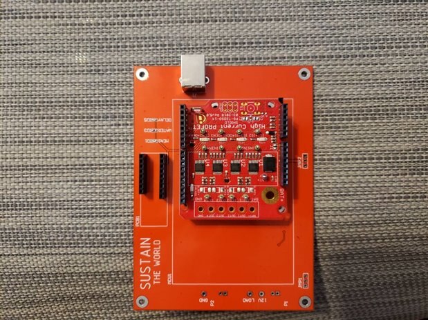

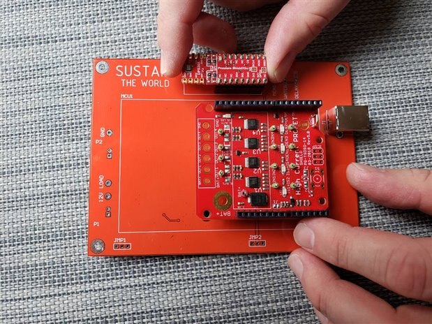

The first module installed on the carrier was the PROFET 2+ Shield.

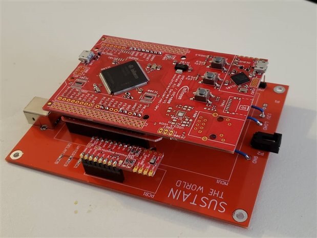

Then I installed the DPS368 Pressure2Go module.  He's a cute little guy... smaller than a stick of gum.
And finally, on top of the stack, we have the XMC4700 Relax Kit board.
Wow, I was so impressed with how everything looked together.

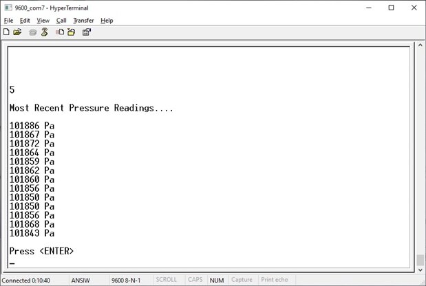

I had greater success with the data logging function.  On Sunday night, I 'left the Relax Kit to its own devices'.
After 3 hours or so I checked to see what data was logged.  The results are shown below:
So, yeah, its kind of cool that it can run autonomously, record data and make decisions based on that data.
