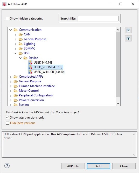

In DAVE you can add Virtual COM port support to your project by adding the USBD_VCOM APP.  See screen shot below:
               Figure 1 - Adding USBD_VCOM

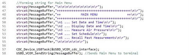

The first of these used was the USB_VCOM_SendString function, and as its name implies it's used to transmit a string out to the Virtual COM port.
In the code below, I use the USB_VCOM_SendString function to transmit the Main Menu string to the host PC.
          Figure 2 - Sending Main Menu String
You'll notice that the USB_VCOM_SendString function call is preceded by a call to the CDC_Device_USBTask function in line 57.
The 'help file' for USBD_VCOM states that is a general management task for a given CDC class interface and is required for the correct operation of the interface.
They also state that it should be called frequently.  In fact the code above doesn't work when the line calling CDC_Device_USBTask is removed.

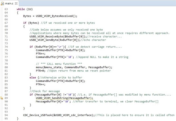

The other ready-made functions that were used are:
USBD_VCOM_BytesReceived() which returns the number of bytes received from the host.
USBD_VCOM_ReceiveByte which is used to receive a byte from USB.
USBD_VCOM_SendByte which is used to send a byte to the host.
The screen shot below illustrates how these functions were used.
               Figure 3 - Receiving and Sending Characters from/to Host
You will see that at the bottom of the while loop, on line 94, I have another call to CDC_Device_USBTask.
Its position here ensures that it is 'called frequently'.

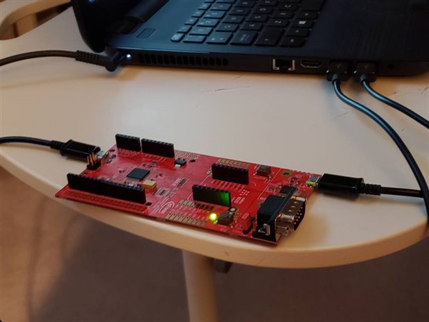

My existing hardware setup is shown in the photo below.  As a special homage to John Woo my development board is 'rocking' two USB connections.
One is used for uploading code.  The other is used for communicating with the host PC.
          Figure 4 - Rocking 2 USB Connections

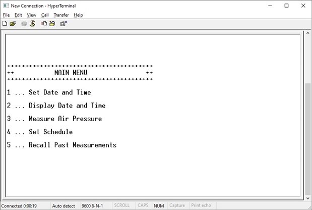

My host PC is running Hyper Terminal. (Yes I was visited by the Ghost of Operating Systems Past).
Anyway, as a parting gift I leave you with an image of Hyper Terminal displaying the main menu.
          Figure 5 - Flashback from the 1990s
