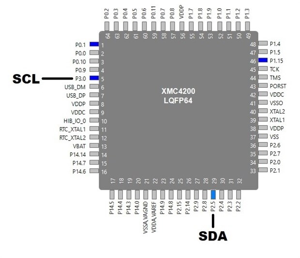

This week I decided to experiment with the DPS368 Pressure Shield2Go module.
The module was installed onto one of two available sites for Platform2Go modules.
I used DAVE to assign SCL and SDA to P3.0 and P2.5 respectively.
