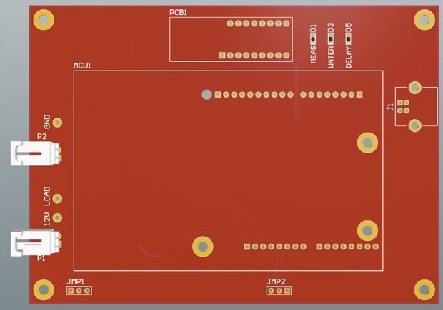

With that said, I am excited to start working with the XMC4700 Relax Kit.  It is the more compact of the two boards, and it's well suited to be integrated into systems as a daughter board.  However, the Relax Kit doesn't have any dedicated Shield 2Go sites.  To compensate I decided to design a simple carrier board.  This approach should result in a nice clean platform by reducing the number of cables.
Top Side
The top side of the carrier board is shown below.  The Relax Kit is installed onto the carrier using a set of Arduino compatible connectors.  The site for the Shield 2Go module is situated towards the top of the board.  This is where I will install the DPS368 Pressure Shield2Go module.

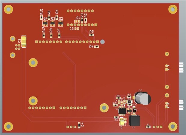

Bottom Side
The bottom side of the board is shown below.  The lower right hand side of the board features a switching regulator that will convert the +5V DC input to +12V.  Generating the +12V onboard in this manner will save me from buying a wall wart power supply to produce this rail.
At one time spinning a board for the sake of cable management would have been cost prohibitive.  However, in recent years many overseas options for inexpensive PCB fabrication have emerged.  The cost for ordering  5 pieces of this PCB design is $20 and that's only because I requested red solder mask.  Had I chosen green, white or black solder mask, the cost would have been a mere $13.
