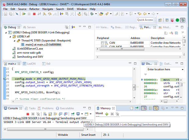

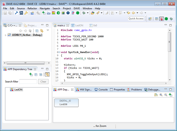

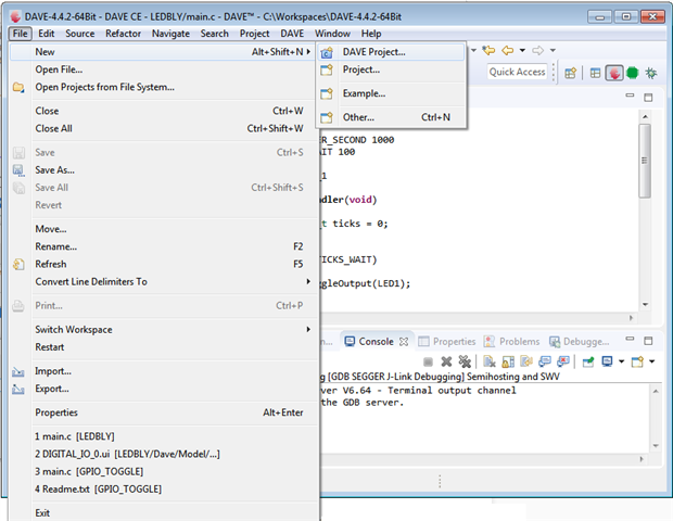

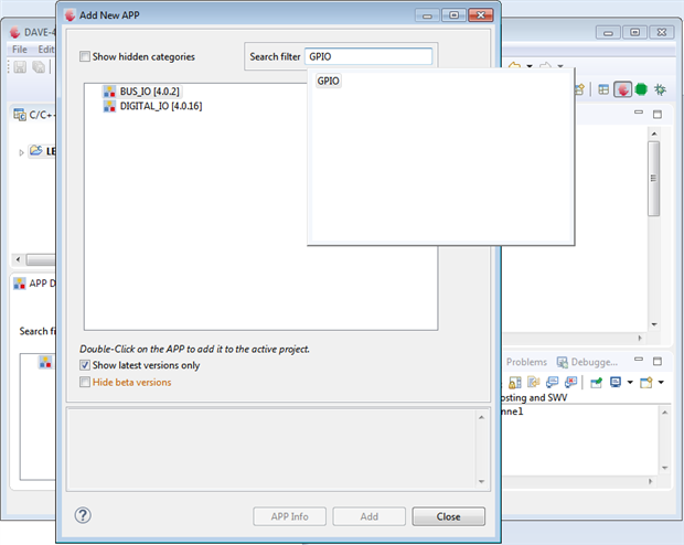

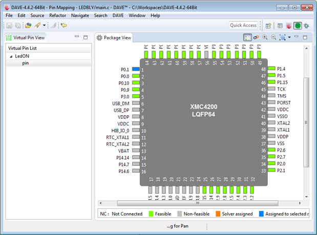

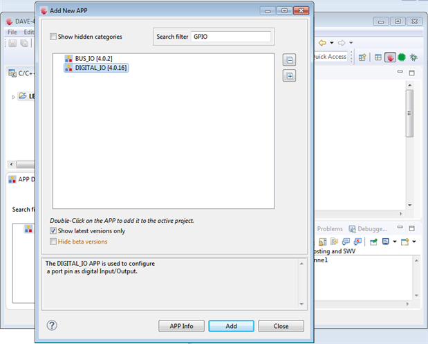

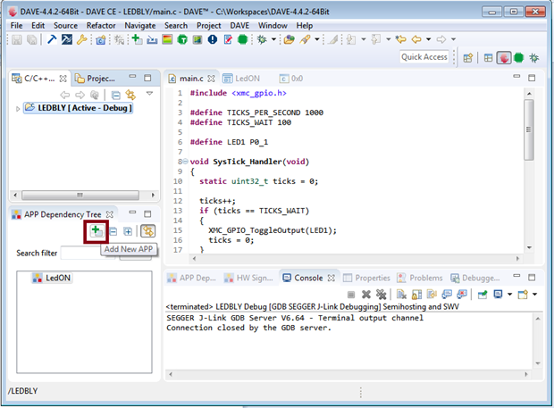

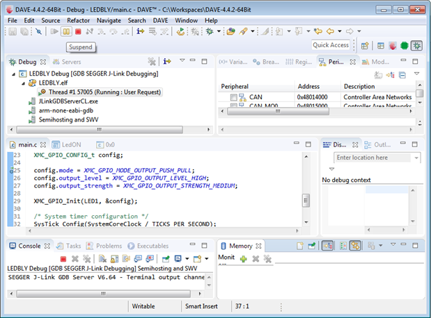

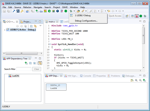

The below images shows step-by-step to configure and program in DAVE IDE.
Program:
#include <xmc_gpio.h>
#define TICKS_PER_SECOND 1000
#define TICKS_WAIT 100
#define LED1 P0_1
void SysTick_Handler(void)
  static uint32_t ticks = 0;
  ticks++;
  if (ticks == TICKS_WAIT)
    XMC_GPIO_ToggleOutput(LED1);
    ticks = 0;
int main(void)
  XMC_GPIO_CONFIG_t config;
  config.mode = XMC_GPIO_MODE_OUTPUT_PUSH_PULL;
  config.output_level = XMC_GPIO_OUTPUT_LEVEL_HIGH;
  config.output_strength = XMC_GPIO_OUTPUT_STRENGTH_MEDIUM;
  XMC_GPIO_Init(LED1, &config);
  /* System timer configuration */
  SysTick_Config(SystemCoreClock / TICKS_PER_SECOND);
  while(1)
    /* Infinite loop */
