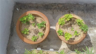

In the present blog I would like to give on idea to set the watering time for different sized pots. In the below figure the two pots can water upto ONE minutes based on Flow Rate 80 L/H.

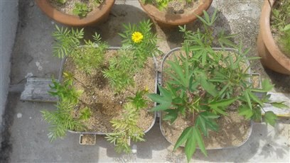

In the below figure Two tray are used for Marie-gold, Zinnia flower plants, roselle plants to grow it require half liter of water that can be distributed with the DC Water pump for this the motor should run upto HALF minute  with a flowrate of 80 L/H

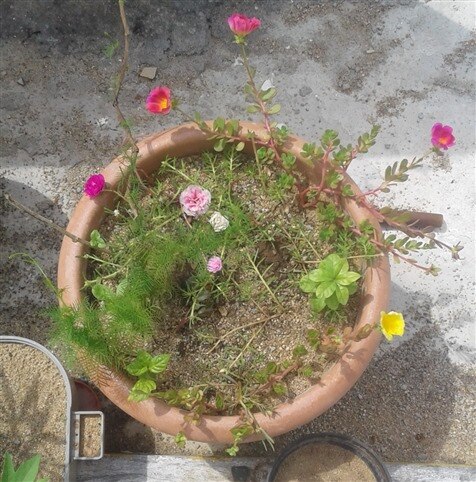

In the below figure a big size pot with different moss rose plants and flower plants are placed it require Two liter of water so the motor can run upto TWO minutes

    karthickiot over 5 years ago in reply to DAB
    Hi DAB,
    Thanks for watching my blog, I really felt happy for your keen observation on soil. The entire soil in the pot was not like what we can see from the image. It consist of good organic but what you said was absolutely correct. I just placed a thin layer of sand on that organic soil to avoid the direct sun exposure on organic soil to keep it wet.
    Thanking you.
    DAB over 6 years ago
    It looks like you are using a very sandy soil.
    Your plants will require more water and food using that type of soil.
    You might consider adding more organic material to the mixture to improve water retention.
