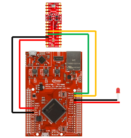

Measuring the temperature and pressure around the coastal water is necessary in order to understand the effects of climate change that affect are coral reef. The DPS368 offers a low power consumption solution to monitoring the coastal areas in a long term operational life span of the device.
testing setup
for reference:
https://github.com/Infineon/XMC-for-Arduino/wiki/XMC4700-Relax-Kit
https://github.com/Infineon/DPS368-Library-Arduino
The xmc4700 is the perfect microcontroller alternative to the arduino uno to communicate with the DPS368.
I used the i2c protocol for the data communication. It gives an accurate reading compared to the SPI channel.

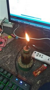

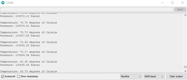

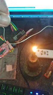

I tested the DPS368's temperature reading by pinching the sensor softly to see changes in data.
NOTE: Please don't pinch the sensor to much as this will disrupt the i2c communication.
To test things further, i used a gas lamp for the sensor to read the data.
NOTE: Please don't put the sensor too close to the flame.

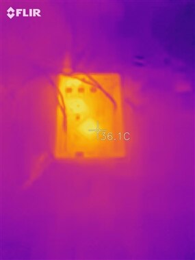

I've compared the reading with my thermal camera and the DPS368.
The test concluded that the DPS368 has an accurate temperature reading. This will help the platform get an accurate reading of the temperature in the coast above or under water. We can now code the XMC4700 to give a signal whenever a certain temperature threshold is reached. In this blog that example would be a LED turning on when the temperature reaches 30 degrees Celsius.
