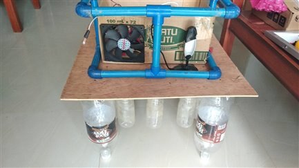

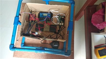

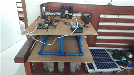

With the solar power installed, we can now assemble and test the rest of the peripherals.

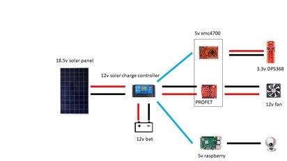

I run some test on the platform and some issues came to light. I suspect the source of this problem is the power distribution or the solar charger controller itself. First is the raspberry pi not booting but LEDs are on. The second issue is that the DPS368 is on but not transmitting data.
Should reconfigure my setup? Should I add more solar panels or battery? How do I sustain the power supply of this platform, etc... I would like to know your thoughts on this.
Nevertheless I attempted to install the electronics inside the platform to see if it floats at sea. Although issue are present in its operation, regardless I am curious how it will hold its own at sea. I can fix these issue later, but for now I must go on an adventure on the beach.
