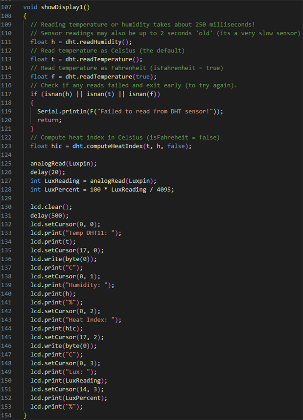

Also, do not forget in the code to place the reading check line
if (isnan (h) || isnan (t) || isnan (f))
     Serial.println (F ("Failed to read from DHT sensor!"));
     return;
As for the analog sensor, set A Vref to 3.3 V in my case, I also used 12-bit resolution throughout the application for all analog sensors.

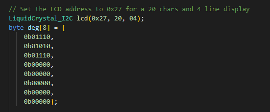

To take care of the details on the display, also create a custom character for the ° C (so it looks cool)
