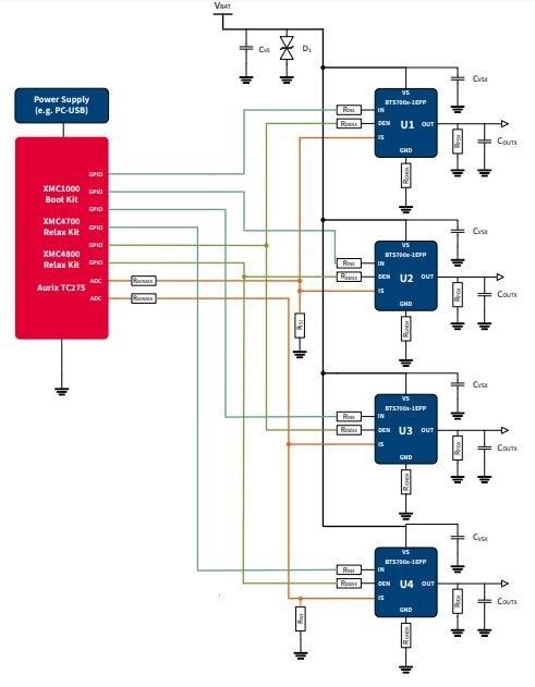

Wiring diagram

Another useful function is Diagnosis. The Diagnosis Enable (DENx) and the current sense (ISx) are conntected in a way, that you can only use 2 different BTS700x-1EPP at a time (U1+U3 or U2+U4). The current sense outputs of the devices U1 and U2 are connected by sharing one ADC input of the microcontroller (analog input A2). The same applies to the devices U3 and U4 which are connected to the analog input A3.
Since jumper J1 is not connected, the microcontroller board is powered by the USB port to the microcontroller to supply the device.
