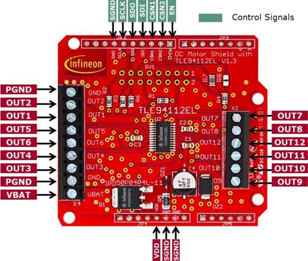

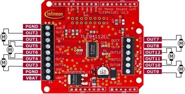

1.  Description of Motor Controller  TLE94112 for Arduino
The DC motor control shield for Arduino is equipped with the TLE94112EL, a twelve-fold half-bridge driver with integrated power stages.
Key rating ,

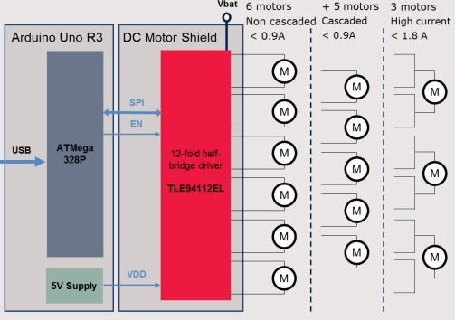

  • Brushed DC Motor Control up to 0.9 A peak, 5.5 – 18 V normal operating input voltage, 18 – 20 V extended operating input voltage and  Maximum input voltage up to 40V (absolute max. rating)
  • Control of: Six independent bidirectional DC motors or  Eleven cascaded bidirectional DC motors
  • Motor speed control by PWM,  Three independent PWM generators, with PWM frequency: 80 Hz, 100 Hz or 200 Hz, 8-bit resolution, 0.5% duty cycle steps,
  • SPI interface for high configurability and detailed diagnosis
  • And protetion of Overtemperature, Overcurrent,  Undervoltage,  Overvoltage
Typical application can be,

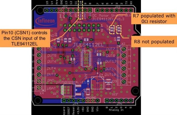

Stacked two shield shall be configurated with following steps,
  • The Pin 10 of the Arduino Uno is used by default to control CSN (Negated Chip Select) input of the TLE94112EL, the pin 9 of the Arduino Uno can be used instead to stack two shields . In this case, the resistor R7 must be desoldered (Figure 9) and a 0 resistormust be soldered on the footprint of R8.
  • The CSN input of each TLE94112EL must be controlled individually by different microcontroller GPIOs: - The TLE94112EL of one DC Motor shield is controlled by the pin 10 (default setting), The TLE94112EL of the other DC Motor shield is controlled by the pin 9.
With pin definition,

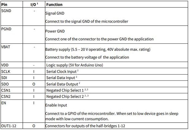

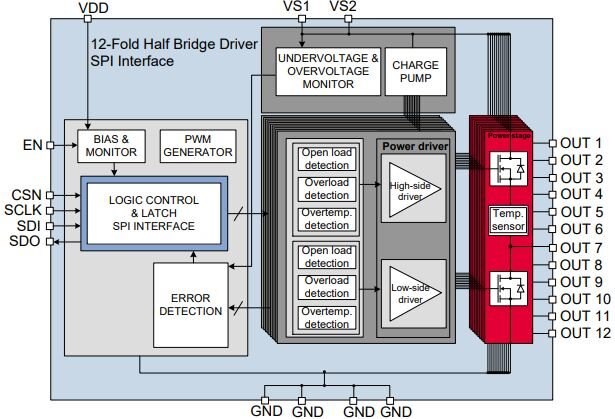

2. Understand TLE94112EL
The TLE94112EL is a protected twelve-fold half-bridge driver designed especially for automotive motion control applications such as heating, ventilation and air conditioning (HVAC) flap DC motor control.
With the block diagram
Demo control of DC motor with OUT1 and OUT2,
As in board ,

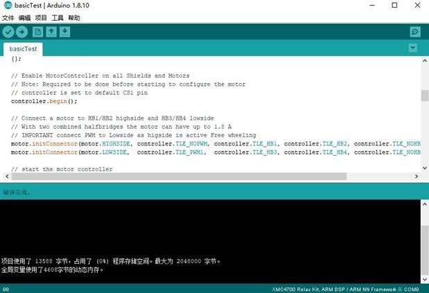

3. Control with Arduino
Same as Smart Switch of previous blog, import the lib first, and open the sample sketch,

Build on arduino,
With arduino, the conrol of motor is easy, just init the motor , select pin configuration and pin control , the command sent by SPI to control DC motor on the shield . This is simple control of one motor, if more be connected, just import the lib can control it.
