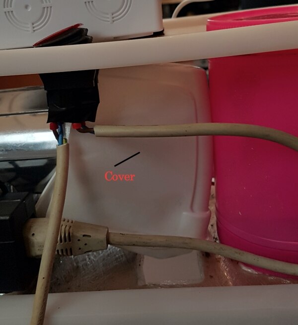

As I mentioned in Blog #9  that I need to change bigger motor and do the cover for the grinder. Here is the picture of my handmade cover.
I bought the new bigger motor and yes it consumes more current.   My current motor driver did not work anymore.
I had changed from full bridge to half-bridge with HB1, HB2, HB3, HB4 connect to low side. I do need to change my Arduino program too.
The update source code is available at GitHub https://github.com/wtos03/WasteFoodMgmt.

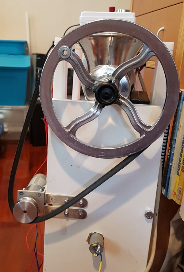

I also change the grinder's rotor for bigger diameter. This will increase more Power.  Here is the picture of the new installation motor.

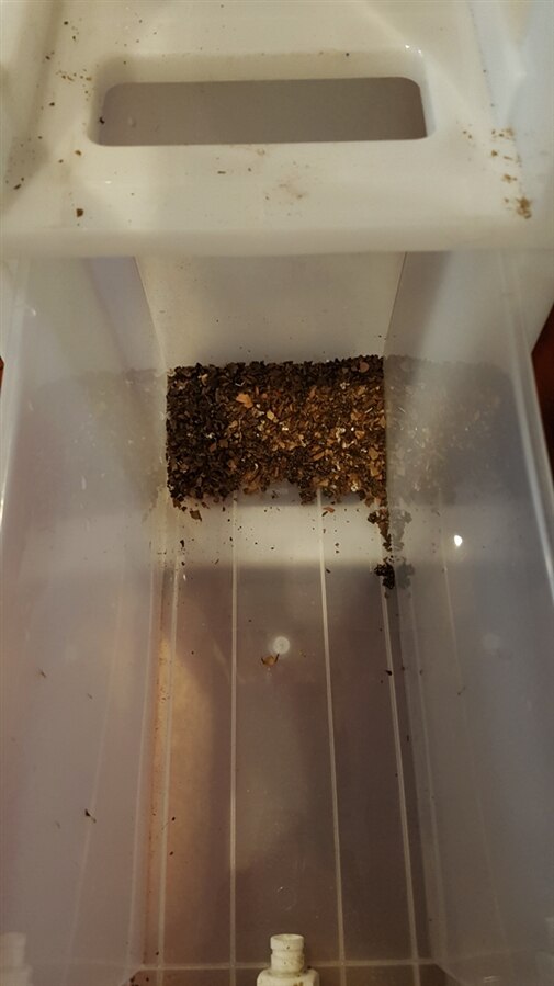

After changing motor, I gott better power.  I tested with egg shells, it’s working fine. You can see
in my update Video for testing here.
However,  for hard shell-like watermelon. The machine still doesn’t have enough power to crush into
small pieces.

At final,  here is the finished products I got from this machine.  You can use it in your garden perfectly.
