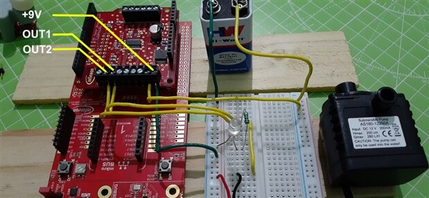

In our case we are going to drive a 12V DC motor pump. The Motor is rated to 350mA. we going to combine two of the outputs (OUT1 & OUT2) and connecting to
negative side of motor. Also we enable the PWM channel for OUT1 and OUT2 with frequency of 200HZ.

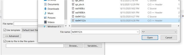

we are going to add SPI drivers in our GPIO LED project, I noted one thing in DAVE IDE, could not rename the project (->feedback to infineon-> Rename feature is important  )
An SPI example project is found under XMC4300 ->  XMC_Peripheral_Library_v2.1.24\XMCLib\examples\XMC4300_series
We use this project as a reference to port into XMC4200.
Its a bit tricky to add or link the existing files from the source folder. (feedback -> infineon -< i request them to allow right click option to add /link existing .c/.h files )

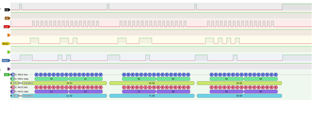

Just check with DSO or Analyzer to confirm SPI communication is proper,
Now we can send the SPI (two bytes) commands to the H-Bridge Shield board.

The DC motor +Ve and Shield board BAT Pin is connected with +9V of Battery. OU1 and OUT2 lines are combined and connected to the  -Ve of DC motor.
To communicate with the h-bridge , the EN pin shou be at high state.

Now the motor starts with PWM value of 250, Inside the systick isr I'm gradually decreasing to level 30 and rising to 250
Observation:
In my case at a speed of 30 PWM -> Motor rotates slowly but could not pump the water.
The motor is rated for 350mA but I could not drive with a single OUT which is capable of 900mA.
