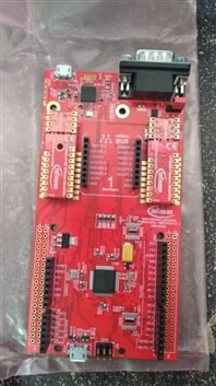

cyberwizard
cyberwizard over 6 years ago
I understand how to code in DAVE for xmc4200, but I don't understand how to code it to integrate the shield2go sensors.
I get that the shield2go can communicate via uart, i2c, or spi, but I don't understand how to implement the communication between the xmc4200 with the shield2go sensors.
the shield2go documents aren't helping because it is all implemented in arduino and I don't have the my IOT adapter.
plz helpz.

    rati89 over 6 years ago
    Hello CW,
    yes you are right, the S2GOs libs only exist for Arduino. However, you can re-use the functions from the XMC libs in the Arduino folders and implement it into Dave, because everything is written in C/C++.
    Therefore you just need to insert the needed functions and definitions. I would recommend to open the files with something like notepad+ or Platform.IO/VS code.
    However, the easiest way is to use Platfrom.IO/VScode or Arduino.
    BR
    Brew
