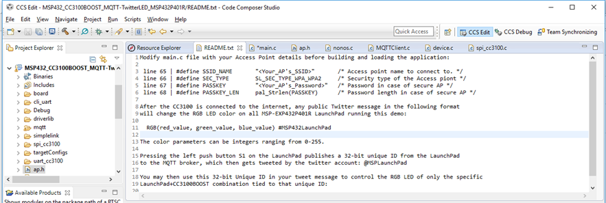

The example is called CC3100BOOST MQTT Twitter LED Example. You can load the source code in Code Composer Studio from the Resource Explorer.
For this project, you need an MSP432 LaunchPad with a CC3100 BoosterPack mounted.
Both have to be connected via USB (The MSP432 to program and debug it, the BoosterPack for power via USB only).
Warning: if you have created WiFi connection profiles on your CC3100 in the past, this example wipes them. You can recreate them later.
Open the README.txt file and follow the instructions to set up connection parameters.

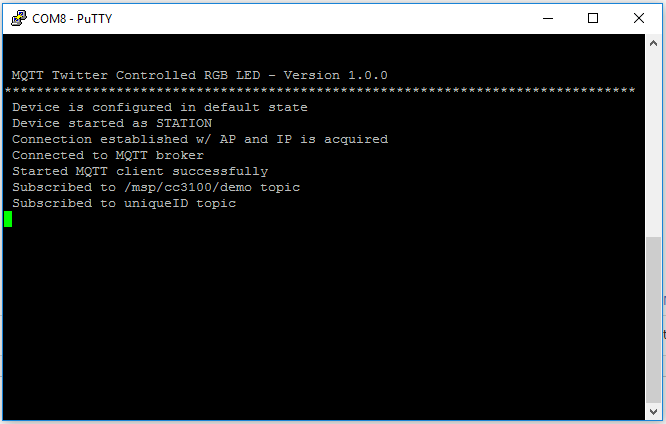

Compile and start the Debugger.
Open a terminal program and connect to the LaunchPad. 9600, 8, 1, N
Execute in the debugger.
You'll see the following in the terminal:

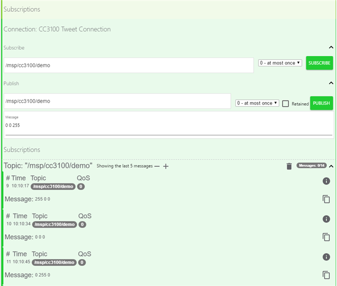

  • or (less annoying to your tweetiverse) by using an MQTT GUI and submitting a MQTT topic:
    Get hold of a MQTT client program (I used MQTT Lens today)
    Connect to this host (leave *all* other values as is):
    iot.eclipse.org
    Then publish the following topic:
    topic: /msp/cc3100/demo
    message: red_value green_value blue_value
    (replace each value by a number between 0 and 255)
The result, whatever the method you have chosen, is that you can control the brightness of the three LEDs on the LaunchPad.

1: SSID and Password in Source Code
#define SSID_NAME       "<Your_AP's_SSID>"       /* Access point name to connect to. */
#define SEC_TYPE        SL_SEC_TYPE_WPA_WPA2     /* Security type of the Access piont */
#define PASSKEY         "<Your_AP's_Password>"   /* Password in case of secure AP */
#define PASSKEY_LEN     pal_Strlen(PASSKEY)      /* Password length in case of secure AP */
The instructions of the example ask you to put the WiFi password in the example.
The CC3100 can save the logon profile in persistent storage.
What would need to change in the example to use that?

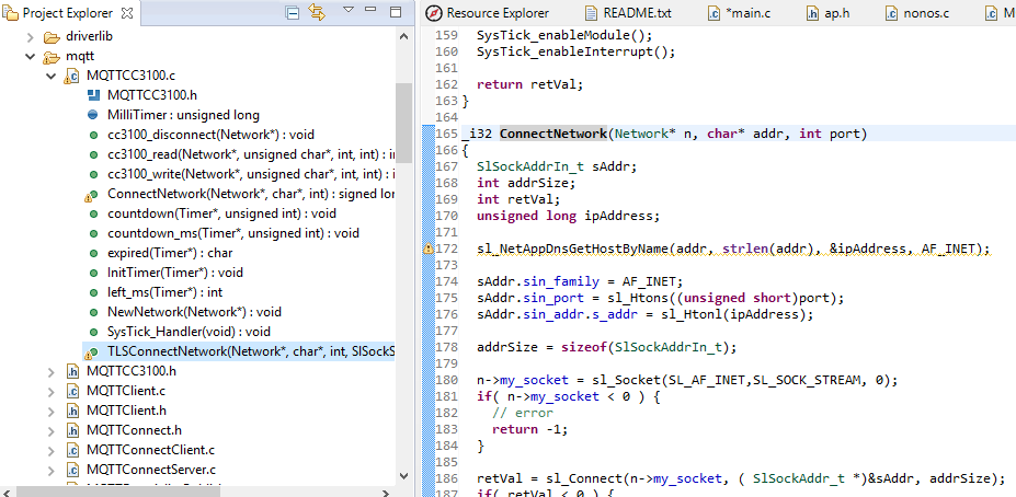

4: Plain Text Connection and Communication to MQTT Server, no Credentials
   rc = ConnectNetwork(&n, MQTT_BROKER_SERVER, 1883);
We're not passing any credentials to connect to the MQTT server.
The MQTT library has other connection methods. Any one knows how to change the code to step away from TCP?
And what additional infrastructure would be needed (certificates, a MQTT server that supports a protocol better than TCP, ...)?

    Jan Cumps over 9 years ago in reply to clem57
    I'd like to check what can be done to get a safe MQTT conversation.
    That's not straightforward, because for encrypted connection, it's required to load certificates to flash.
    For this boosterpack, that requires additional hardware. (not. see below)
