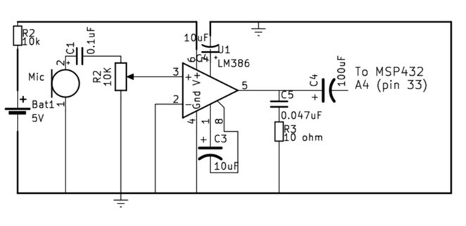

   Currently, the audio circuit that I have been working with includes a LM386 and an Electret Mic connected to a MSP432 via A4 and processed to produce an output fed to a LED Bar Graph as an indicator of the noise level the mic is picking up.  This is a variation of a Non-Inverting Op AMP.  The sound is detected by the Electret Mic connected to pin 3 of the LM386 via c1 and R2.  The audio is processed through the OP AMP and then fed back out on pin 5 which is connected to A4 ADC analog input channel 4 (Pin 33) of the MSP432. Once the audio is detected, it is processed and fed back out on pins 23-32 which are connected to the LED Bar Graph as a visual of the audio output. Eventually this will light the wearable with Green, Yellow, Orange or Red depending on the Noise level as well as display on the Sharp LCD, but this is what I have started for now.
Hearing Guard System - Audio Circuit
Hardware Used
MSP-EXP432P401RLaunchpad
LM386 OP AMP
LED Bar Graph Array 10 segment
Electret Mic
1 x 10K Resistor
1 x 10 Ohm Resistor
1 x 10K Potentiometer
1 x 100uF Electrolytic Capacitor
2 x 10uF Electrolytic Capacitor
1 x 0.047 Ceramic Capacitor
1 x 0.1uF Capacitor
Video of what I have thus far
