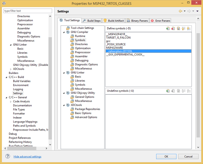

For my Hearing Guard System Safe & Sound Challenge project it was decided to attempt to implement C++ Object Oriented Programming features which includes the use of Classes over the standard C Structured Programming.  As a baseline, I used the 'bigtime' project which can be found in the MSP432 TI-RTOS package. However, I soon ran into a limitation especially when calling the Graphics files used with the Sharp LCD.  Initially, like with the 'bigtime' project, I tried to use the default TI-Compiler TI v16.12.0.STS.  The issue is that the grlib libraries use defined variables such as 'int8_t' which are typdef'd as '__int8_t' and is defined as follows
  typedef signed char __int8_t ;
The problem is that the the TI-Compiler  TI v16.12.0.STS only supports up to C++03, C Compiler defaults at c89, which does not include defined C99 types from C so I kept getting compiler errors.  After some research, and many a late night hacking,  I found the GNU compiler that can be added to CCS via the CCS App Center tool does support up to C++11 and includes support for the C99 style int8_t and other defines. Thus, I added this to CCS, 6.2 in this instance, and then Created another project via 'Project->New CSS Project' and Selecting Compiler Version GNU v4.9.3 (Linaro). Set a Project name and then under 'Project Templates and examples' select:

               I. GNU Compiler
                    1. Symbols
                         i. Add the following
                              a. '__cplusplus'
                                   1. Value = 201103L
                              b. __GXX_EXPERIMENTAL_CXXOX__

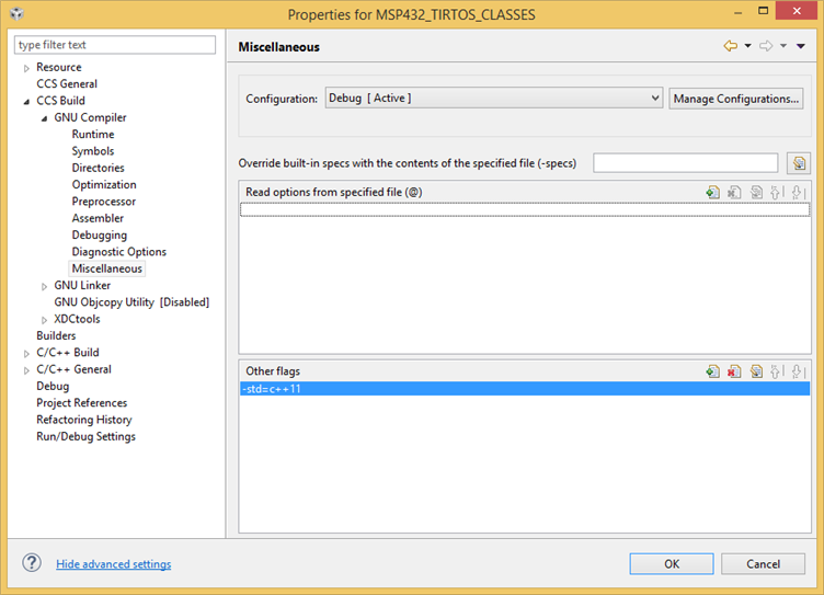

                    2. Miscellaneous
                         i. Other flags:
                              a. Add
                                   1. -std=c++11

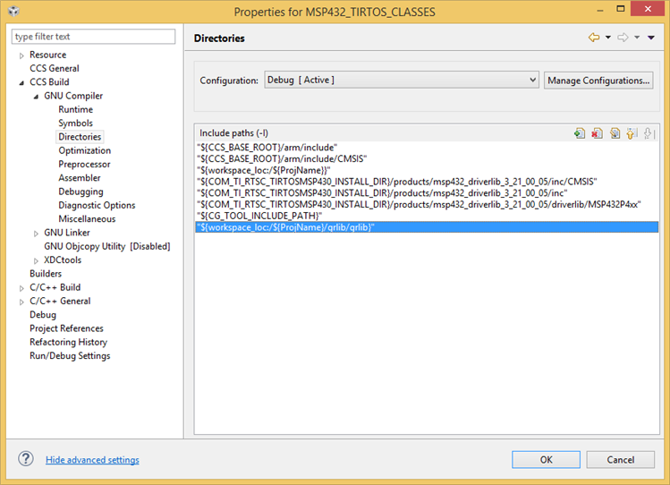

                    3. Select Directories
                         i. Under 'Include paths (-l)' add
                              a. Directory path to the grlib/grlib folder in your workspace
                                   1. ex: "${workspace_loc:/${ProjName}/grlib/grlib}"

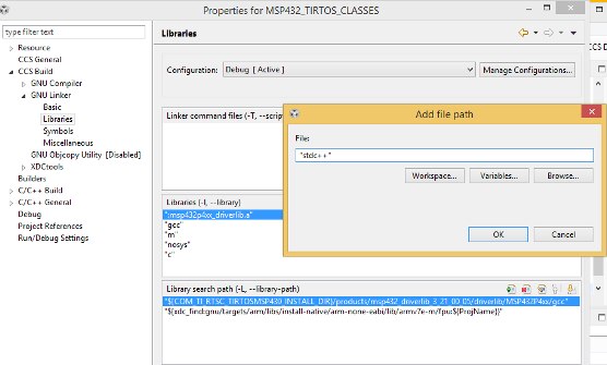

     3. Still in the Properties window, in the left window
          a. Select CCS General
               I. GNU linker
                    1. Libraries
                         i. Libraries ('-l, --library)
                              a. Click Add
                                   1. Enter: “stdc++”
                                      NOTE: use quotes around stdc++

                         i. GNU Compiler
                              a. Symbols
                              NOTE: ensure the following settings performed previously are set
                                   1. __cplusplus
                                        i. Value = 201103L
                                   2. __GXX_EXPERIMENTAL_CXX0X_
                              b. Miscellaneous
                                   1. Ensure Other flags has
                                        i. -stdc=c++11

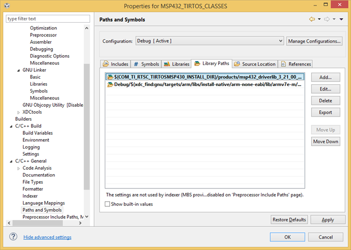

          b. Select C/C++ General
               I. Paths and Symbols
                  1. Library Path tab
                        i. Ensure the TIRTOS path is set to the appropriate path for the 'gcc' compiler
                            NOTE: TI-RTOS for MSP432 in this instance for the MSP432 Launchpad
                                                ${COM_TI_RTSC_TIRTOSMSP430_INSTALL_DIR}/products/msp432_driverlib_3_21_00_05/driverlib/MSP432P4xx/gcc

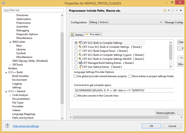

               II. Preprocessor Include Paths, Macros etc.
                  1. Providers tab
                         i. Ensure the only 'CDT GCC Built-in Compiler Settings' is selected:
                            NOTE: All other options are not selected.
                         ii. In the Command to get compiler specs, add the following:
                              a.  '-std=c++11'
This should get the environment set to for c++11 style development in TI-RTOS using Code Composer Studio.
