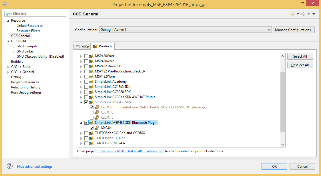

So , part of my switch in project, was to use the The SimpleLinkTm SDK Bluetooth Plugin for the MSP432, more specifically Project 0.
http://www.ti.com/tool/simplelink-sdk-bluetooth-plugin
This can be accomplished by added the Bluetooth Plugin to the main project via Properties:

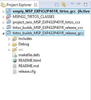

The way this is designed is that the main project and the TI-RTOS part are in separate projects within the workspace. I highlight the two projects that I am using for this after setting things to GCC. The other projects are my attempt with my original C++ project that still fails to compile as well as the original Project 0 project folders:
With this, the config file for the combined project is located under the tirtos_builds_# folder (seen as release.cfg above), so if there are any overall project settings needed, these are made in this location.
One of the main issues I ran into was that I had tasks with associated semaphores used to control difference events in the tasks that were in separate files in my main project folder.  This seems to pose an issue with the BIOS kernel in that it seems to treat items such as tasks and semaphores defined in a file as static to that particular file and is not visible to other tasks located in another file.
To get around this, I ended up putting these tasks and associated semaphores into the release.cfg file and then added the 'global' define into the appropriate file where these are referenced.
