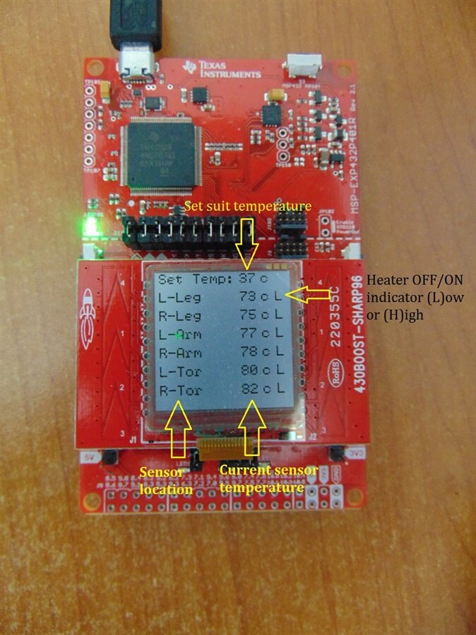

Here is where I am at so far. I am waiting for my temperature sensors to arrive (Taking a lot longer then expected). I do have everything else required to complete the project. For the past week, I have
been working on sewing the carbon fiber into the suit as well as programming the  MSP-EXP432P401RMSP-EXP432P401R to regulate the suits temperature I will be using an 8 Relay Module to control the power going to the carbon fiber
For those of you interested in the Carbon Fiber, here is the link: http://www.carbonheater.us/
Below is the code I am using for the suit (Still more to add). I am using Energia 1.6.10E18 to program the EXP432.

Below is a picture of the code running on the MSP432 with the SHARP96 (ignore the suit temperatures as I don’t have the temperature sensors as of yet)
    DAB over 9 years ago +2
    Nice start. Your picture had me worried until you wrote that you did not have the sensors attached. 80 degrees C is too much. DAB

    dwinhold over 9 years ago in reply to DAB +1
    Hi DAB, That is why I added the note. I can't wait for the sensors to arrive, I will finally be able to put it all together and test it out. After that I will be adding new ideas to the suit. Dale W
