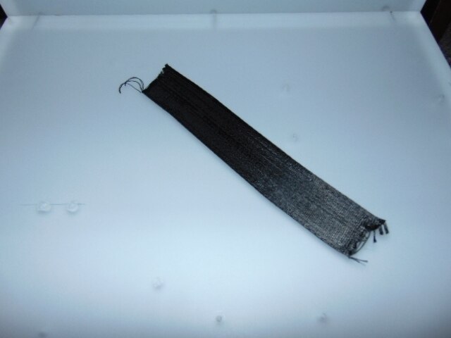

Hello everyone, this post is about carbon fiber tape and how it will be used.

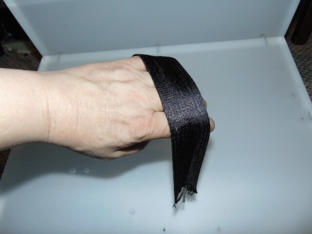

The carbon fiber tape has arrived!! This update is showing how well the carbon fiber works as a heating element. Below are pictures of the carbon fiber. In them you can see that it is like fabric, it feels like silk. I am using 18650 3.7v 2600mAH batteries, I have purchased 8 of them hoping that will be enough for the entire suit to operate; they are rechargeable!!
Here is some interesting fact about carbon fiber:
It’s very soft, thin and flexible which enables it to be used in a wide range of textile applications where it may be subjected to continual movement and bending. The carbon fiber tape has similar characteristics to other heating elements available on the market however it is unique because of its flexibility and softness. In addition, another crucial factor with carbon fiber tape is that, unlike conventional heaters, it emits infrared heat that not only warms the top layer of the body but can also penetrate up to 5cm deep into the body making it far superior to other heating solutions currently on the market.

Here are the specs for the tape I am using:
Carbon fiber tape
Specifications:
Material:
Carbon   fiber 100%
Type:
Heating element
Resistance:
18±2 Ohm/m ( 5.5±0.5 Ohm/ft )
Weight
5±0.5 g/m (1.5±0.15 g/ft)
Width:
17±2 mm (0.67±0.08 in)
Thickness:
0.6±0.1 mm (0.024±0.004 in)
Tensile  strength:
50±10 kg
Pictures of the carbon fiber:

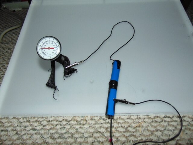

Set up for the temperature test. I wanted to see how hot an 8" length piece of tape would get with 2 - 3.7v 2600mAH batteries for power.
Watch the video to see the results (3.5 minutes long). Sorry for it being dark (and me babbling on and on).

    dwinhold over 9 years ago in reply to dougw
    Thank you dougw for the reply and questions!!
    I just went and re-ran the test with the volt meter. First I tested the resistance (My sample piece of carbon fiber was bigger then the 15mm wide tape I am using (test was on tape 44mm wide and 250mm long). I will run tests on the tape I will be using. Anyway, the resistance is 3.8 ohms. The initial voltage when connected was 2.8v and at 140 deg F it was 2.95v and at 215 deg F was 3.05v. I was using 2 batteries 3.7v 2600 mAH  (7.48v on the volt meter).
    Dale
    dougw over 9 years ago
    Interesting material - thanks for blogging about it.
    What is the resistance of that strip?
    I think the thermal coefficient of resistance for carbon is slightly negative. Does this mean the current in your tape goes up as the temperature goes up?
