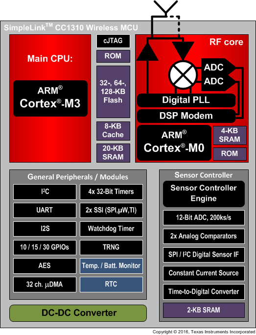

The CC1310 is a sub Ghz single chip solution that run its RF core on a Arm Cortex M0 and the Application processor is an Arm cortex M3 which means it is very flexible in terms of applications. Since things can get very complicated very quickly, TI recommends not developing native applications like for the MSP430 and AVR that is the bread and butter of most firmware. Instead, they recommend using TI RTOS to host your applications and provide a generous load of examples and what not to aid getting of the ground quickly. Unfortunately, there is more than one way to skin a cat and Code Composer Studio can seem downright scary to the new-comer. In this article, I discuss the use of TI RTOS with CCS 7 and touch on pThreads for the POSIX aware readers out there.

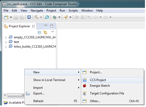

Install em and create a workspace in your favourite location. There are now two ways to create a project. The first is to simple right click in the project explorer and select 'New CCS Project'

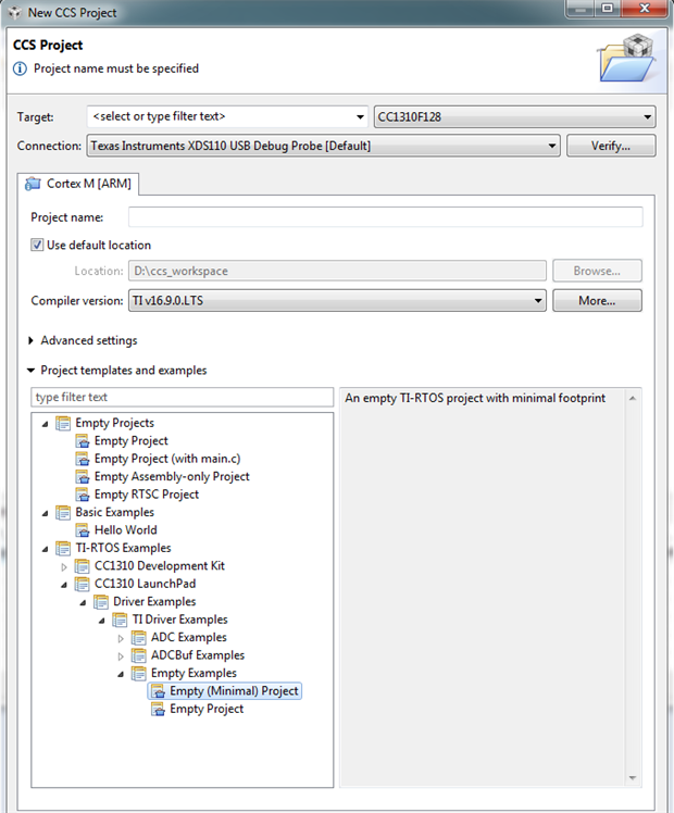

Flow the rabbit and select TI-RTOS empty (minimal) Example and give it a name.
Press that hammer button to check if it compiles. It should. The example comes with a Blinking LED Task that allows you to check if everything is all right and if you connect and program your launchpad, you should be able to see things work. For a demo and instructions on method two, take a look at the video below.
