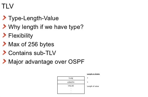

What is TLV?
A quick search on google reveals that TLV stands for Type-length-value. In this protocol, we start by sending the type parameter to indicate communication type and consequently the length of the entire structure and finally the value to be communicated. This is basically what we did the last time around with the difference that we now want to simplify things. There are no address or misc bytes of data.
I have used TLV in another project here https://www.element14.com/community/groups/lighting/blog/2016/01/16/multipurpose-modular-light-bar-project-08-mqtt-communications-at-the-cc3200--javascript-paho-and-tlv-protocol where it was piggybacked on MQTT.

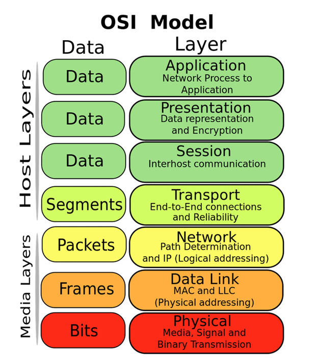

Where is it and why do we need it?
In our case, we will be piggybacking it on our Network Layer.
The essence of a protocol stack is that each layer has an individual function and each layer has some specific functionality. In our case, the stack looks like…
|         TLV Layer/Session layer                    |
|        Network Layer/Base protocol            |
|        Physical Layer/Serial/UART               |
This relates to the OSI model and theoretically not all layers are necessary. An Application layer will sit atop this stack and that is where the primary application code resides and takes decisions etc.
We require this middle layer so that if we decided to use the same application with TCP/IP sockets or even MQTT, this layer can be modified without modifying the application code. This facilitates portability and the application can be developed on Windows, tested on Linux and finally implemented on a BeagleBone Black.
The implementation will be similar to what is discussed in the previous post here (https://www.element14.com/community/community/arduino/blog/2015/01/24/dynamic-living-room-lights-the-tree-code-explained--write-a-protocol-with-interrupts)
