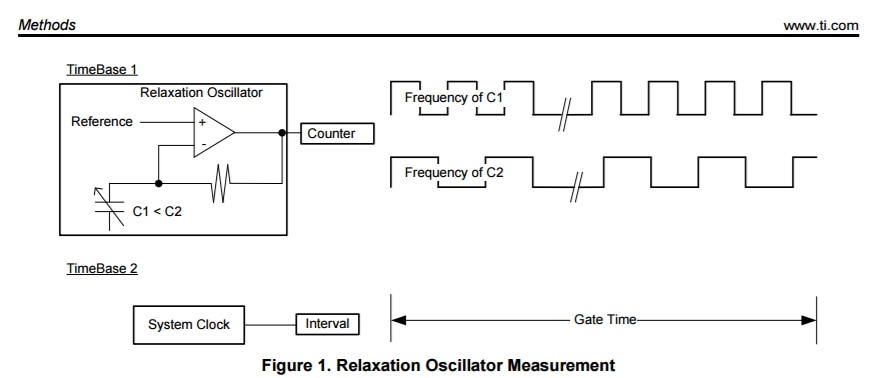

Capacitive touch sensing in the MSP432
I've already touched (get it? touched?) on this topic on my second blog post, but here is a short recap:
The capacitive sensing method being used by the MSP432 is the relaxation oscillator (RO) method. The internal oscillator has a variable frequency as a function of capacitance. As the capacitance increases, the oscillator's frequency decreases. A second, fast timer, is used to count the number of the RO pulses that fit within a certain time interval. When a person touches the sensor he causes the capacitance to increase, hence causes the frequency and number of pulses to decrease. The software can than detect this change in number of pulses and trigger a certain action.
The MSP432 is already equiped with all the necessary hardware to implement RO based capacitive sensing, so only the an external sensing element is needed and the software are required.
The code implementation is based on the TI's Capacitive touch software library. I found it rather difficult to figure out the various timer configuration required, but fortunately, my application is very basic in terms of the many features the library provides and it turned out to be rather simple to make use of the basic API's.
According to TI, the library provides three different layers of abstraction. I'm using the lowest level which is the TI_CAPT_RAW function. This function provides the raw capacitance measurement (number of pulses) to the application layer. The other layers implement various baseline tracking algorithms (i.e., determine a reference value for the capacitance. A change in capacitance will be sensed relative to this reference value). For now, however, I find it more straightforward to monitor the raw values and set an appropriate threshold manually.

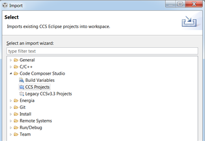

1. Download the 432CAPSENSELIBRARY from the above link and unzip the file.
2. In CCS, import the project intro the workspace: File --> Import --> Code composer Studio --> CCS Projects

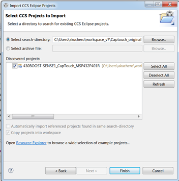

3. Click Browse and navigate to "Download Folder"l\Firmware\Source\430BOOST-SENSE1_CapTouch_MSP432P401R\CCS. Finally, click the "Finish" button and the project should be imported into the workspace:

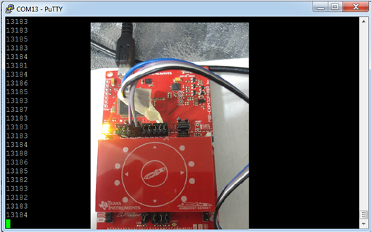

Testing it out:
1. Connect the Capacitive touch booster pack to the MSP432 Launchpad.
2. Build the project and program the MSP.
3. Open a serial monitor and observe the changes in the number of counts when touching the middle sensor. So, as expected, we see that touching the sensor reduces the number of counts that fit inside the measurement interval.

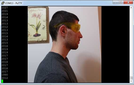

  • Test it out with the glasses: The left photo shows the capacitance measurement with the glasses off and the right one shows it with the glasses on.
         Great! we see that wearing the glasses increases the capacitance that is connected to P5.0 at thus reduces the number of counts.
