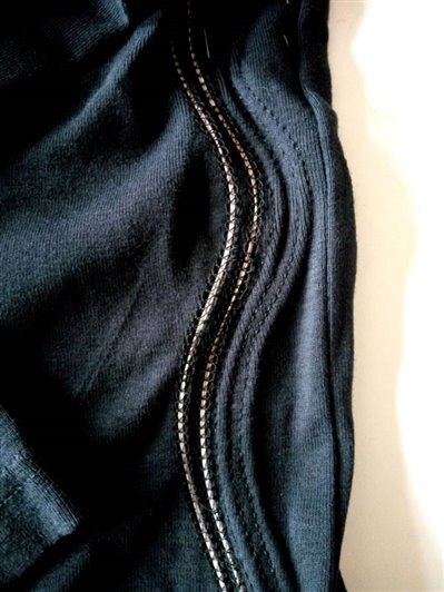

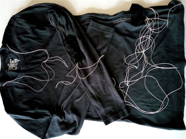

While I'm waiting for the kit, I'm engaged in continuing development with the equipment that I have.
The Shirt!
My friends from Mukachevo University helped to sew a test version of the shirt for sensors that are installed on the human body. In those places where sensors will be installed, pockets are sewn.
As connecting wires, I used a multicore wire with teflon insulation 0.5 mm in diameter. Due to their high flexibility, these wires are very user-friendly and almost invisible to the user. They are well protected from external influences (sweat, temperature, etc.). The truth is, I do not know yet whether it is necessary to use shielded wires. But I think that it will work fine for the first time.
When the human body moves, the wires must be fixed, for this they are laid with a snake. At the weekend I'll fix the sensors.

    Using twisted pairs of wires and using of common mode rejection capability of an Op Amp to cancel the noise is good idea. I'm test this variant. As You can see on photo, I use small pockets for the sensors…

    As You can see on photo, I use small pockets for the sensors.
    Thank' DAB for good ideas!
    DAB over 8 years ago
    Depending upon the signals you need, you can run twisted pairs of wires and use common mode rejection capability of an Op Amp to cancel the noise.
    You could use small pockets for the sensors or use Velcro areas to get them optimally placed on each person.
