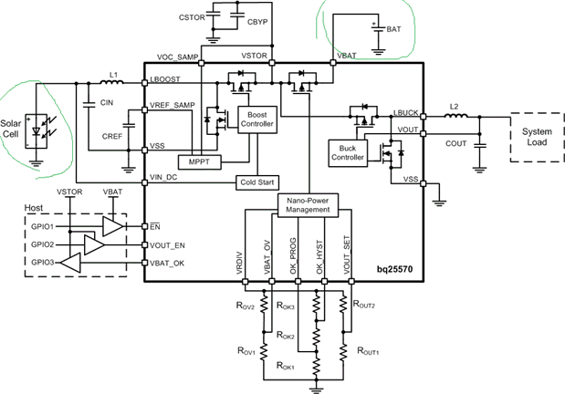

From TI websit there is the schemetic to show how the solar panel is attached and how the battery is charged.

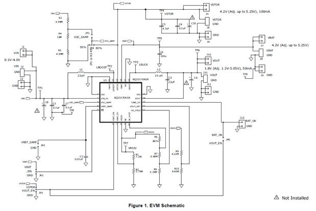

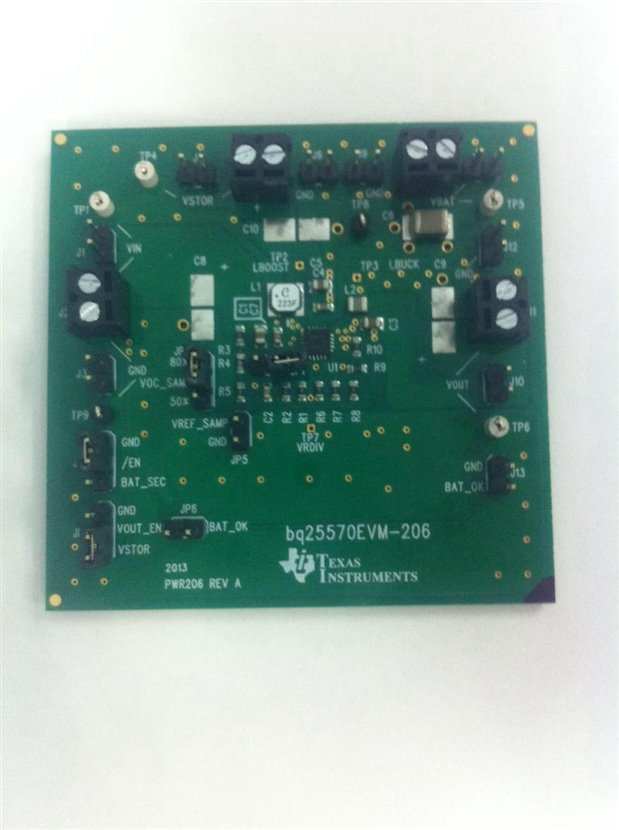

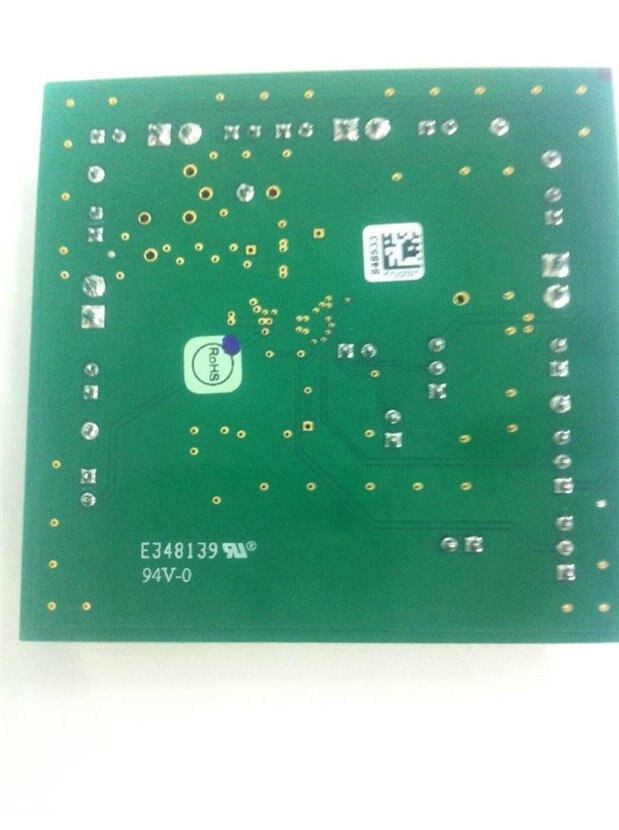

2. BQ25570 EVM board
The shipment of BQ25570 EVM board is used for battery charger evaluation,
the schematic as follows,
The recommended power source shall be high impedance low current power source like solar panel, the power load can be one super capacitor or load resistor.
There are several tests for this board in attached manual, it would provide useful information for the possible application of this bq25570 EVM.
