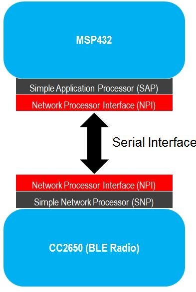

1. The BOOSTXL-CC2650 is BLE/ZigBee supported dual stack development board. The MSP432 and CC2650 shall be connected via serial interface,

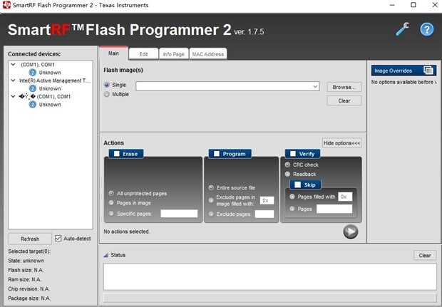

2. The official instruction on CC2650 programming shall be under the following Flashing Programmer
The hardware connection shall be as follows,

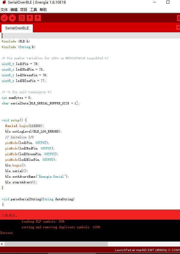

3. While energia can be programmed for MSP432+CC2650 , here is example for serial over BLE,
Download to MSP432 launchpad,

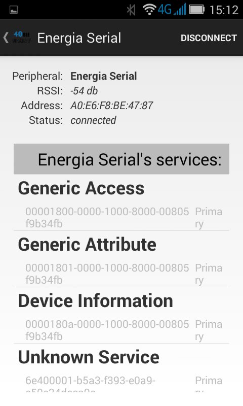

Then the BLE scanner in mobile receive advertising signal,
The BLECharacteristic  data is,
