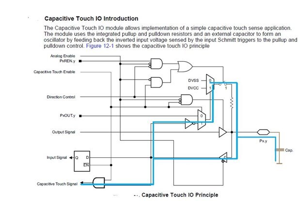

According to my research, MSP432P401 has offered great resource for capacity sensor for touching, motion with  capTouch libraries. Since I mean to make design in Energia, which function of timer is confined a lot. In the end, I try customized Tick Count and make results in the end.

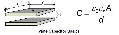

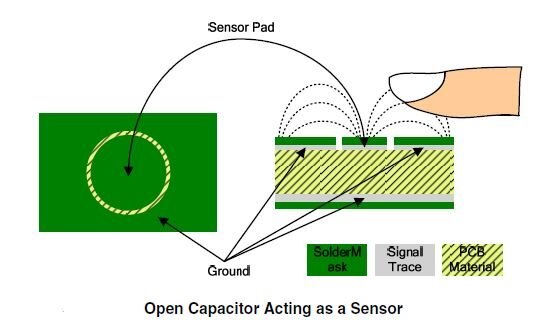

2. The fundamental element required in the capacitive touch sensing application described is the variable capacitor itself. This capacitor should be easy to construct as well as sensitive to human touch in order to enable this as an alternative to mechanical buttons and switches. Such a touch sensitive sensor element can be constructed by “opening up” a capacitor structure so that the electric field can be interfered with by a conductive foreign object, in this case, a finger. The figure below shows the touch sensor.
It would be same if the capacitive water level sensors since water pose larger dielectric constant of 78.36F/m , in that

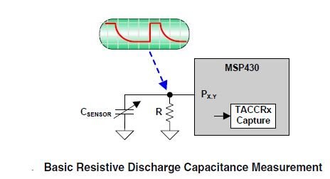

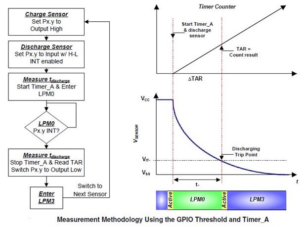

There are two methods of capacity sensor, Oscillator-Based Capacitive Measurement or Resistor-Based Capacitive Measurement, I use the later,
using an external resistor to charge or discharge the given capacitive sensor. Using the port pins of the MSP430 to charge or discharge the sensor cap, the internal Timer_A can be used to measure the corresponding charge or discharge time. Given a fixed external resistance to provide the charge/discharge path, the capacitance of the sensor can be measured.  With reference design on MSP430,
In fact, for MSP401r, capTouch is one of bottom function in MCU, simplified with one pin without external component, which can be studied later.image

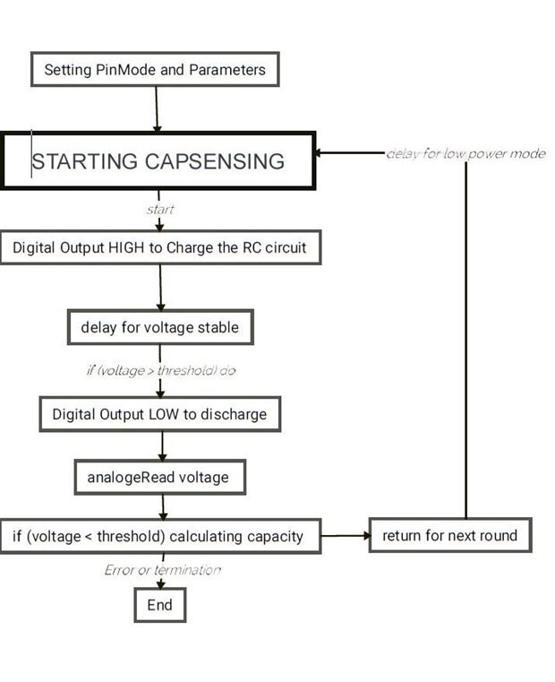

3. Capacity sensor with program logic as follows,
4. The Energia Sketch as follows,
at first, I have tried tickTime= millis() for acurate time span, but it return 0. The timer still can not catch the transient state or RC circuit, so  I have to use capCount as tick counts for on and off of hand touch.

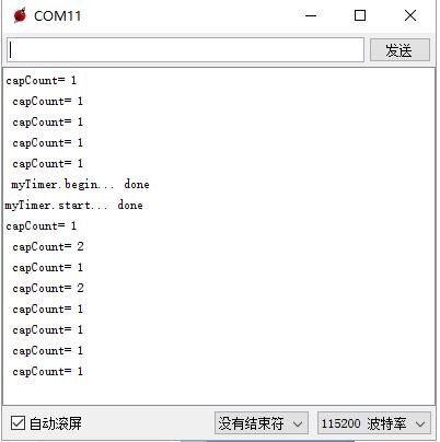

with the result in serial console,
capCount number 2 show the touch of hand to input Pin and 1 for not.
The result is not idea and the parameter are not selected well, larger resistor and capacitor shall be used for this test. But at least ,it works and it is a good start to go.
With water level sensor, the capacitor is much larger than hand proximate, it will work well ,but thoroughly math calculation is needed.
