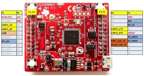

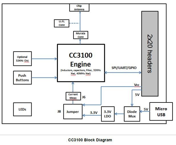

1. The CC3100 BoostPack can be plugged into the MSP432 lauchpad for wifi connection, with the following block diagram.
with Hardware Features
• 2x20 pin stackable connectors
• On-board chip antenna with option for U.FL-based conducted testing
• Power from on-board LDO using USB or 3.3 V from MCU LaunchPad
• Three push buttons
• Two LEDs
• Jumper for current measurement with provision to mount 0.1R resistor for measurement with voltmeter
• 8 Mbit serial flash (M25PX80 from Micron)
• 40 MHz crystal, 32 KHz crystal and optional 32 KHz oscillator
Hardware connection as

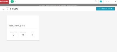

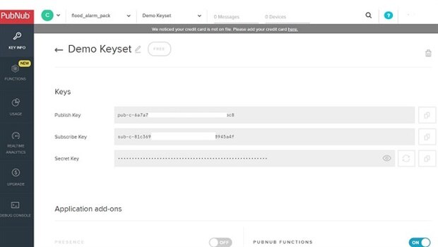

2. To use PubNub service, one app shall be created,
the publish and subscribe keys are set automatically.

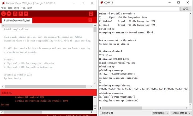

3. The open energia for PubNubDemo sketch, with code,

In this sketch subscribe key and publish key shall be put to proper value above.
