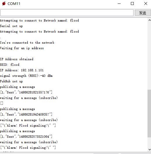

1. PubNub.com has provided great tools for publish channel over PubNub service over internet, the website can response to the request by subscribe the channel, only subscribe key is needed for this service. Of course, this can be done by AWS IoT service, but PubNub is the easiest and secure.

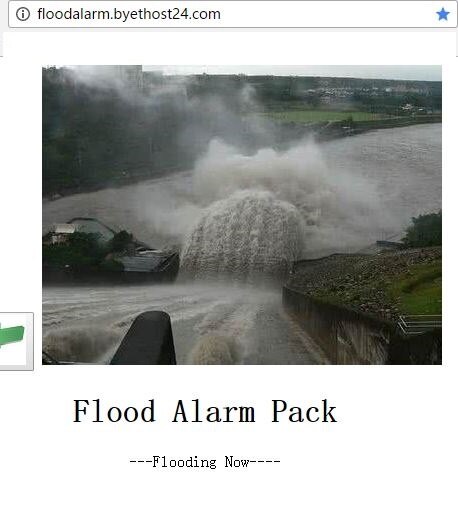

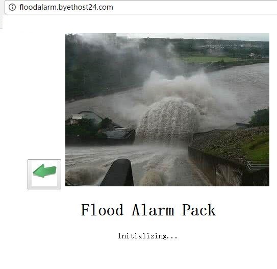

2. I have registered one simple website for this project as flood_alarm,
Then power the development board with CC3100 boostpack plugged, waiting for publish over pubNub,
The web subscribe the channel and response with flooding now alert.
3. Now the design loop closes. The alarm pack get water level by capacitive sensing, publish the topic (or Channel) via pubNub service to web portal that subscribe the topic (or Channel).
More service like SMS can be added later. Now I can  polish the code and adjust the parameter.
