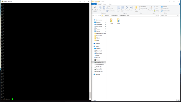

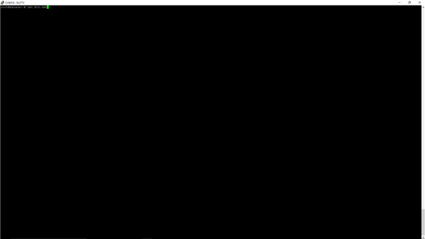

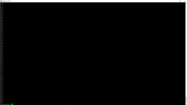

Hello guys,
This week we gonna send the data received by the Edison to a local along with a Video feed.
For now I'm sending out the ECG data, and the video feed to a local cloud, our pc.
All the source files can be found in our Github repository.
Here I'm sending ECG data captured to Edison, from there (along with a video feed) to the FTP server, a php script fetches the data and plots the ECG graph and a visual too.
We are using Wamp, our windows PC becomes the local cloud.
What we've done
Created a ftp Server in Windows PC
Install mjpg-streamer on edison "opkg install mjpg-streamer"
I'm using Logitech C270 which was fortunately supported by Edison.
  " mjpg_streamer -i "input_uvc.so -n -f 30 -r 800x600" -o "output_http.so -p 8080 -w ./www" "
for streaming video on http://192.168.1.xx:8080/?action=stream
run upload.py
Start Wamp sever and Browse to localserver/T%20Shirt/
{gallery} To the Cloud
Check if ECG data is stored.
Yeah we got the data into the edison
FTP server before receiving the data
Yeah we got the data in Server, the "ECG.txt" file
and to the cloud, the php script plots the ECG graph and the video feed
