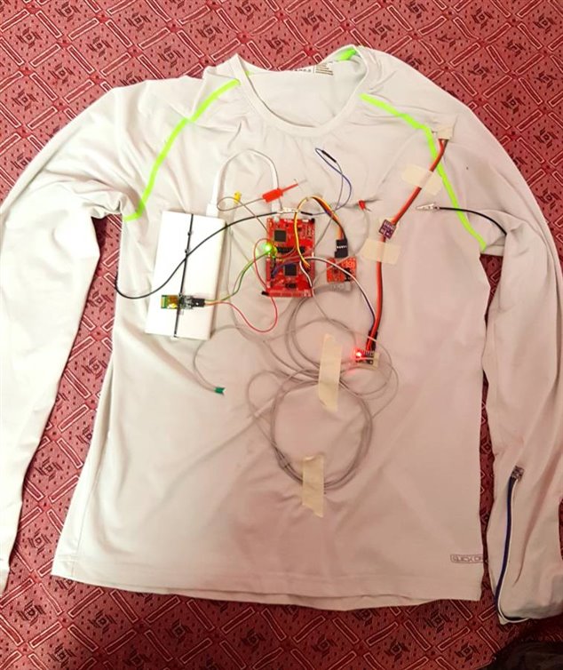

So the setup and everything is the same.

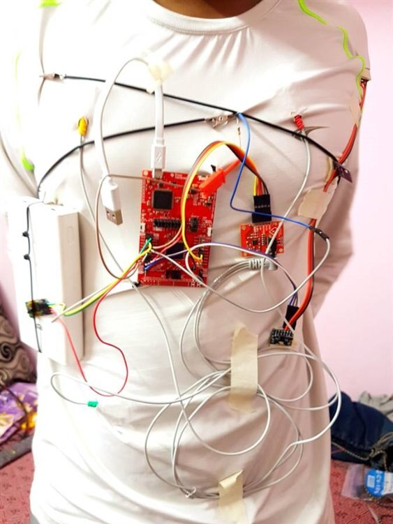

I'm just gonna show the Demo here. I don't want to fall from the bed so made a slight change in the LaunchPad Code, so that it relays the collected data to Edison.
We also attached a 5V led module to the Edison, So that if the Lighting is dull it would turn it ON. Well it worked as expected.
You can get all the codes, the Android APK into our GitHub Rep.
The Setup
We are using a Power Bank for powering the T-shirt.
Its Dark and I'm Falling....
Time to test things, I Just added a few lines to the unified program, so it pushes all the data collected by the sensor, I don't want to fall from the bed image.
Well the Edison Switched on the Light, Pushed the things into the Cloud, and our Page Displayed a Live feed with the Vitals,

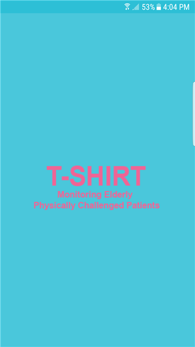

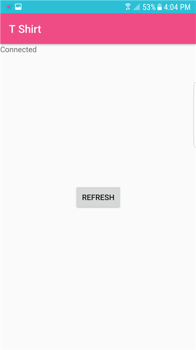

The App
image     imageimage

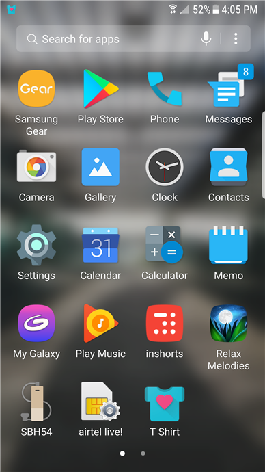

We also built the Android App.

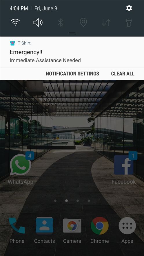

Lets see if we get a Notification, Yeah We do got it,
So yeah we successfully done it!!
