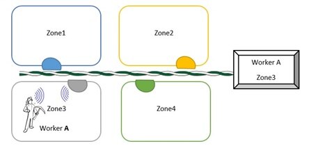

My project proposal will be designing a wearable device that will display surrounding environmental information to the miner and to develop a system to track the location of a miner working inside the mine.
Project Description:
A wearable device will be mounted on Miner's wrist which will display information on surrounding environment like -
  • pressureimage
  • ambient temperature
  • humidity
  • ambient light
A system based on NFC/RFID or BLE will be designed to locate the working zone of the Miner.

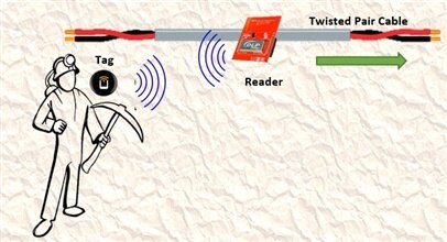

for locating the miner's working zone, BLE or NFC/RFID based solution can be used.
My choice will be the NFC transceiver.
The NFC transceiver can be used to locate the presence of the Miner.
A Type 2 RFID tag will be installed inside the wearable device.
So, whenever the miner will enter to a certain working zone, the RFID reader will sense the presence of the miner and send the data to central monitor using a wired communication like twisted pair cable.
In that case, the operating range of the RFID reader may need to be extended by using external antenna.
