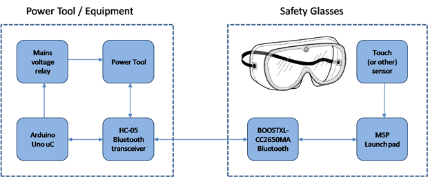

Hello everyone! Welcome to my (late) introduction blog. I'm very excited to be a part of this challenge and wish good luck to all participants!

The idea is relatively straight forward: Sensor equipped safety glasses that can detect whether they are being worn by a worker/operator. The glasses are wirelessly linked to a power tool or some other equipment that require the use of safety glasses. Unless the power tool receives a signal, indicating the operator is indeed wearing the safety glasses, it will not switch on, thus forcing the worker to put the eye protection glasses on.
General description
The project will consist of two units: the safety glasses unit and the power tool unit.
The safety glasses will be equipped with the MSP processor , Bluetooth transceiver, and a combination of sensors. The sensor’s function is to identify that a worker is indeed wearing the safety glasses.
Meanwhile, the power tool to be operated is not working since the mains switch is open and the tool is not receiving any power. Only when the above mentioned signal from the glasses is received, does the switch closes and allows normal use.
Safety Glasses unit
The main challenge will probably be to implement a reliable human-skin detection which will be hard to fool, but no too cumbersome.

Power tool unit
This unit's implementation should be relatively straight forward. It will be based around an Arduino UNO and a HC-05 bluetooth model.
Once the appropriate word is received through the BT module, the arduino will switch on a relay that will enable the mains voltage to reach the power tool.

The aim of this project is to help reduce the amount of eye injuries in the work place by implementing Smart Safety Glasses. The Smart Slasses will not allow the worker to turn on his equipment unless they are being worn.
Obviously, the biggest challenge of the project will be to reliably detect when an operator is wearing the safety glasses. The second one will probably be the sensors and electronics mounting, such that the glasses could be comfortably used.
Hopefully , the other parts of the project should go relatively smoothly.

    mcb1 over 9 years ago +3
    salexku biggest challenge of the project will be to reliably detect when an operator is wearing the safety glasses You're quite right, but the concept and implementation of the concept is the important…
    Jan Cumps over 9 years ago in reply to DAB +3
    Now that the hipsters have nose- and browpiercings, you could use them as contact points and do a triangular resistance measurement eye -> eye, left-eye -> nose, nose -> right-eye. The glasses would have…
    DAB over 9 years ago in reply to Jan Cumps +3
    Piercings can also create snag points and random circuit discharge points. The first thing we learned in electronics class was to remove rings as they could short out circuits. I can well imagine what…
    I can well imagine what someone with a nose ring would encounter if they got too close to an old style RF Amplifier.
    Just saying, hip is not necessarily safe!
    The glasses would have contact points that meet the piercings.
    HR would only hire candidates with required embellishments available (or that agree to have them placed before first day of employment).
    Great project idea.
    There are number of possible solutions.
    I would consider using an RPI with a camera that could do facial recognition and identify when the operator is not wearing the safety glasses appropriately.
    I suspect visual confirmation is the only reliable way to make sure.
