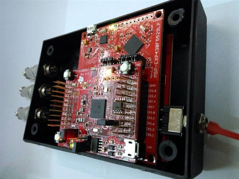

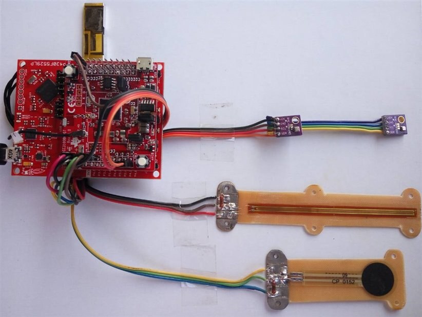

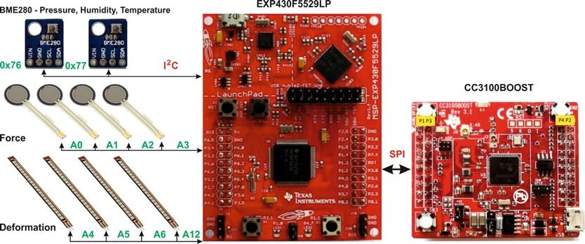

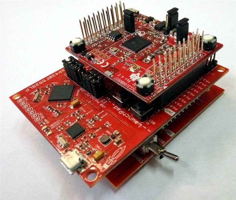

Portable monitoring system for“smart clothes was designed to be fix in clothes and wear comfortably The system consist of main module(device and sensors which connected with module through flexible wires The measuring system consists of pressure sensors(CP 0152 sensors 4pcs and deformation(loading sensors and two combined temperature-humidity-pressure sensors Because sensors are resistive and strain gauge ones for their approval the bridge switching circuit is used The sensors are divided into two groups and powered from digital-to-analog converters(DAC This allows to adjust their sensitivity within a very wide range The signal from each bridge reaches the input of the analog-to-digital converter(ADC The digital code that is responsible for the amount of strain(deformation and pressure is supplied to the input of TI MSP430F5529LP microcontroller(I want to replace it with  MSP-EXP432P401RMSP-EXP432P401R and after pre-processing by Wireless technology to the host computer The reading speed of measurement results changes with the use of the control program and can be within the range of 0-100 measurements per second for one channel
     Two combined temperature-humidity-pressure sensors (Bosch BME280), one of which is under the clothes and the other - outside, allow measuring the microclimatic conditions under the object of study, and controlling the air microcirculation. I2C interface was used to communicate with main board for these sensors. CC3100BP modules organize wireless communication of measuring system. This module give us possibility to send data to any suitable receiver. With this module, we can build truly functional low-power wireless solution. CC3100BP and MSP430F5529LP microcontrollers are connected through SPI. Device is powered by TI BOOSTXL-BATPAKMKII.

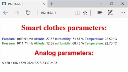

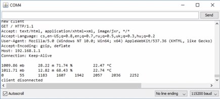

     The main part of measurement system control software was written in Energia MT v.0101E0017. For input data from Bosch BME 280 sensors, we using cactus_io_BME280_I2C library. Reading data from the analog inputs was realized through standard Energiaanalogreadfunction. For communication with hardware (BME280 and CC3100BP) Energia Wire and SPI libraries was used. CC3100 was switched to Access Point mode and Web server on port 80 was started. Monitoring data transmitted to USB-Serial virtual COM port for debugging purposes.

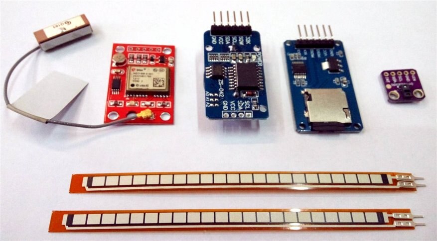

There are plans to add more sensors(infrared temperature sensor accelerometer and gyroscope(for the detection of an explosion or a fall from a height magnetometer(to detect hazardous magnetic fields GPS different type of danger GAS pulse meter and blood oxygen saturation sensor get possibility data storage on microSD card(black-box function Also there are plans to display information on surface of clothes(OLED display and create special software for receiver side and more impressive data presentation on Web-page It give possibility for user to see main parameters and states of internal and outdoor environments I plan to use a new type of powering because typical source(as rule chemical type very depend on temperature humidity and number of cycles of charging Therefore I considered alternative type source such are piezoelectric thermoelectric and biomechanical energy and their combination(very fit the  BQ25570EVM-206BQ25570EVM-206 module

     My project is almost ready, I like to expand and modernize it due to optional equipment and more powerful microcontroller.
     To implement the missing functionality, additional modules were purchased.
image     Until I get the Safe & Sound Design Challenge Kit, I will connect to my system the purchased modules and program them.
