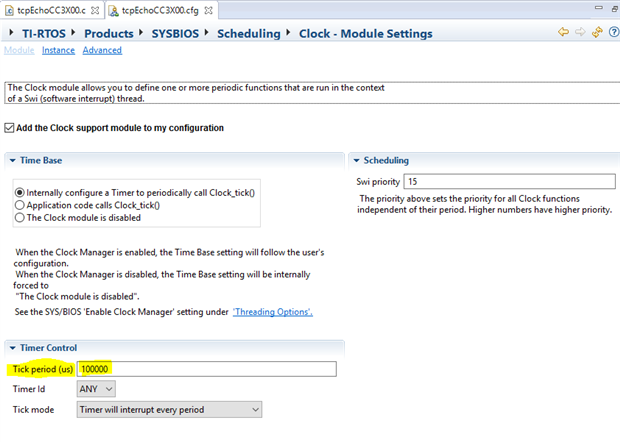

Kits have arrived and hands become dirty image The next day after kits have arrived, I plugged wifi boosterpack and use the Tera Term for communication. It worked without any coding. Great image Well, not really. I wanted to modify the code but I was stuck because I had never used any RTOS. I could use Energia (which is so like Arduino IDE) examples but I want to learn RTOS. It is challenging myself and learning new skills image I went over the online training course and get the basics of the TI-RTOS. I can't say I know the RTOS yet but I start learning maybe after design challenge, I will be knowing RTOS. There are two notes for noobs related to TI-RTOS. First, If you use Task_sleep(10); it doesn't have a constant period. The period is determined by the config user interface as shown below. Therefore Task_sleep(10); will sleep one second (10 * 100 000 us). Second, If you create a software interrupt (or any other task) and want to use them on code interface, you need to include xds/cfg/global.h library.
