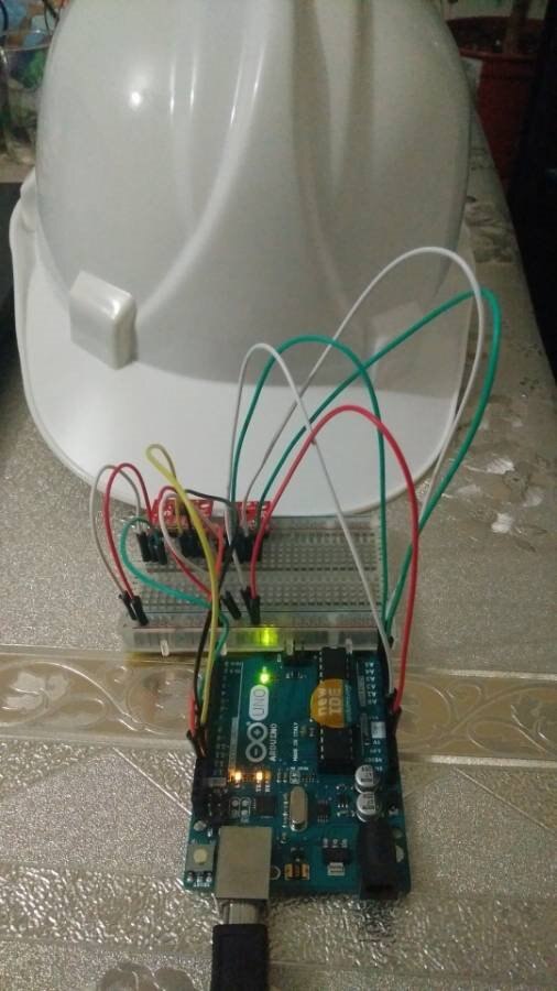

I was absent last two weeks, I hope I will catch up the following weeks image In the last post, I have written about the socket programming and wifi boosterpack. The next think I need to hook up the sensor boosterpack but there were problems. Although bare-metal code for sensor boosterpack works, the sample code for the TI-RTOS didn't work. I didn't want to use the bare-metal code because it was pretty long and timing can be a problem if I combine wifi module and some other stuff. Also, I don't have much time so I came up with separating the sensor board and create sensor board with Arduino.
I have used TMP102 digital temperature sensor and ADXL345 accelerometer. ADXL345 makes things easier because it has an Arduino library wich can detect the inactivity. The code below is getting sensors data and send temperature and activity/inactivity over the serial port. I will connect the serial port to MSP432 and send the data over Wi-Fi boosterpack. I will add a pressure sensor and buzzer to warn the user.
I also got the helmet. I hope this week I will do more work and catch up.
