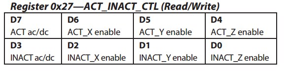

The ADXL345 provides more than x,y,z data. It can provide interrupt for activity, inactivity, freefall and more. To use interrupt we need to set them. ACT_INACT_CTL (value = 01110111) register is control register for activity and inactivity detection.
"Then THRESH_ACT register is eight bits and holds the threshold value for detecting activity. The data format is unsigned, so the magnitude of the activity event is compared with the value in the THRESH_ACT register. The scale factor is 62.5 mg/LSB."

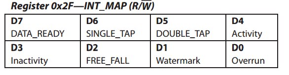

ADXL345 has two interrupt pin but eight interrupt sources. Therefore, we need to map the interrupts for the pins. I am using activity, inactivity, free-fall interrupts (maybe data available when my design becomes more clear).
Any bits set to 0 in this register send their respective interrupts to the INT1 pin, whereas bits set to 1 send their respective interrupts to the INT2 pin. All selected interrupts for a given pin are OR’ed.
I will use interrupt pin 1 for the inactivity and free-fall and interrupt pin 2 for the activity (activity is used to double check). Therefore, I need to write 0bxxx100xx (0b11110011).

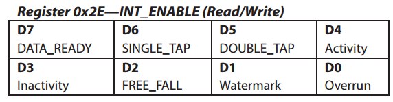

After setting all the values, we need to enable interrupts so we need to send 0b00011100 to INT_ENABLE register.
