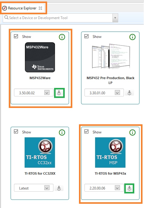

Software Preparation
Install the latest Code Composer Studio. It's available for free (like all software we use in this project) from TI.
When you have it up and running, install the following packages via the Resource Explorer (View -> Resource Explorer)
  • MSP432Ware
  • TI-RTOS for MSP43x
This takes a while and you may need to restart CCS when asked. It is good to have some coffee at hand when doing the installs.
When finished, you get a wealth of examples for the MSP432, bare metal and RTOS based.

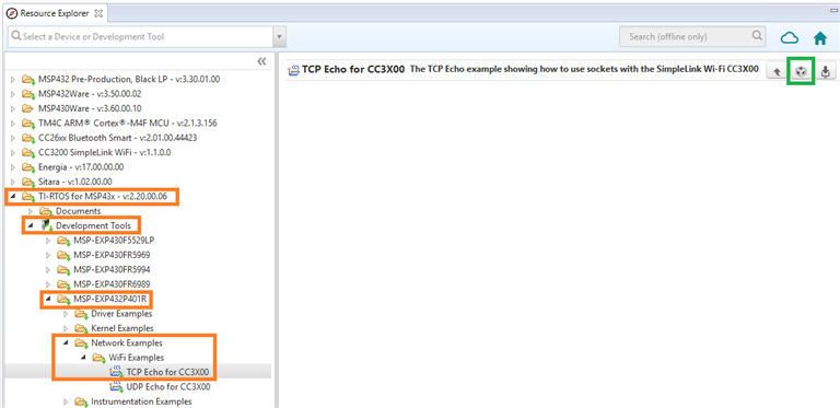

Build the Project Firmware
We're going to run the MSP432/CC3X00 TCP test from TI-RTOS.
You can import that into the IDE via the same Resource Explorer you used to download the packages.
On the left side of the screen, you see a tree with (at least) the two components you installed.
  • Navigate to TI-RTOS for MSP43X -> Development Tools ->  MSP-EXP432X -> Network Examples -> WiFi Examples
  • Select TCP Echo for CC3X00
  • On the right side of the screen, click on the CCS icon to import the project into the IDE.
You now have the source code for the project on your computer, fully configured for the MSP432 and CC3100.
In the Project Explorer on the left side of CCS, you can find that project.
It's good to expand the project and double-click on README.html. The instructions that we followhere will be displayed in the IDE.
  • Select it (its name should now be bold) and build it by pressing the hammer button on the toolbar (or Project -> Build Project)

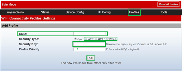

You have now put the BoosterPack in Access Point mode.
  • When you check for available WiFi points, a new one starting with mysimplelink will appear.
    Before selecting it, take care that you have all your Internet dependent applications closed.
    You will very likely loose your internet connection at this point.
    Alternatively, you can do this exercise from your smartphone, tablet or another computer.
  • Connect to the new WiFi provider. No password is required.
  • Then, open a browser and surf to 192.168.1.1
Enjoy this moment. It's your first interaction with the WiFi BoosterPack.
  • Now navigate to the profiles tab, and enter the following info from your home WiFi access point
    • SSID
    • Security Type (let's hope you have WPA by now)
    • The security key of your home access point
    • A priority. Not important when you register a single profile.
The profile will be listed as first profile in the table at the buttom of the screen.

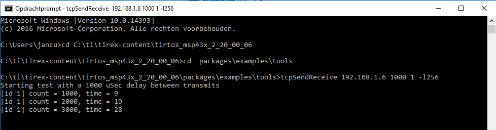

Test WiFi
We'll now test the WiFi connection with a command line utility.

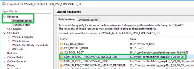

You'll find it in the location where you installed TI-RTOS.
If you don't know where that is, then right-click on the project name in the Project Explorer and select Properties.
The location is shown under Resource -> Linked Resources : COM_TI_RTSC_TIRTOSMSP430_INSTALL_DIR
  • open a command prompt on your PC.
  • navigate to the TI-RTOS install folder (on my pc: C:\ti\tirex-content\tirtos_msp43x_2_20_00_06)
  • Then navigate to packages\examples\tools
Enter the following command - replace the IP address with the one that is logged in the CCS console:
  • tcpSendReceive 192.168.1.6 1000 1 -l256
Enjoy the result:
