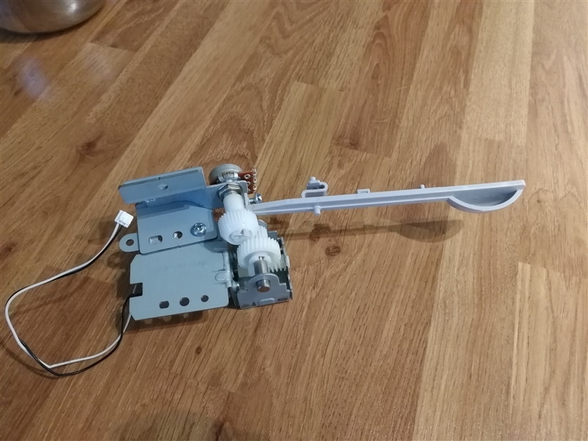

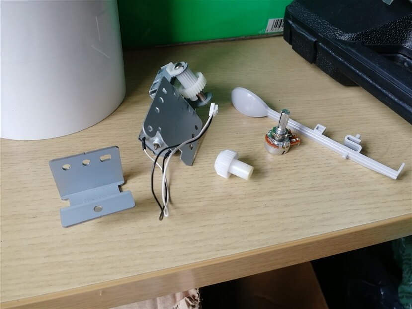

I had some printer parts (motors, gears, sheet metal parts) that I wanted to use to create this robot. Also, I had thought of using the scanner (moving bit) to use as an arm/leg but that didn't work out very well. This is because after experimenting, I found that the power supplied to the motor wasn't enough to generate enough torque to overcome the inertia of the whole part.
image image image
So, I had to use slightly bigger motor and make the arm from other parts. I found a DC motor, metal brackets, and plastic gears. I had bought some encoders and potentiometers to use as angular sensors in this project so that came in handy when I wanted to build this arm.
image image
So anyways, after spending a few hours, I made an assembly that looks like shown in the pictures below. The spoon kind of thing in the pitcure is meant to be an arm which is also sourced from one of the dismantled printers! Smiley
image image

Line 49 - 59 is effectively the bang bang type controller where if the error is negative, full effort (PWM 255, in direction 0) is applied to drive the error down to zero. If the error is positive, full effort (PWM 255, in direction 1) is applied. So, one can imagine that because of motor+gear+arm inertia, delays in the system and full power, the position will overshoot the desired postion and suddenly the program will apply the opposite direction full force, and so on. This is not desirable. This is why I have put a band in line 57 - 59 where the motor does nothing. This is illustrated with a doodle below where without the hysteresis band, the motor starts hunting around the setpoint and with the band, does not.
Of course, it won't be accurate because the motor will stop either too late or too early. Ideally, if precise positioning is desired, PID or other advanced control algorithms should be used. In this scenario though, I didn't have a problem using this controller because it didn't matter if the arm was a couple of degrees off the desired position as this was only intended to show position of the arm in Yoga posture. Please note that I had total increments of 750 from the analogRead for 180 degrees.
OK so now that is enough explanation of the code and reasoning, let's get to action! Here is the video of this arm where I am positioning the arm in several different positions using keyboard entry into the serial monitor.
