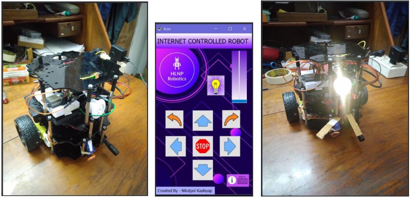

Teleoperation Robot using ESP32 and Firebase Realtime Database
A few months back, I worked on an Internet Controlled Teleoperation Robot which can be controlled over the internet by anyone having the credentials. I used an ESP32 connected to the Internet which reads data from the Firebase database. It had two DC motors for controlling the robot's movement. It had a servo motor which was used to open and close a small gripper arm. It also had a LED light attached at the top.
I made a Desktop GUI using Python and PyQT5 library for controlling the robot. The keys and the slider in the GUI are used to change and update the values in the Firebase Realtime Database. The ESP32 reads the updated data from the Firebase Realtime Database and updates it to control the direction of the motor controls, the position of the Servo motor, and the state of the LED.
