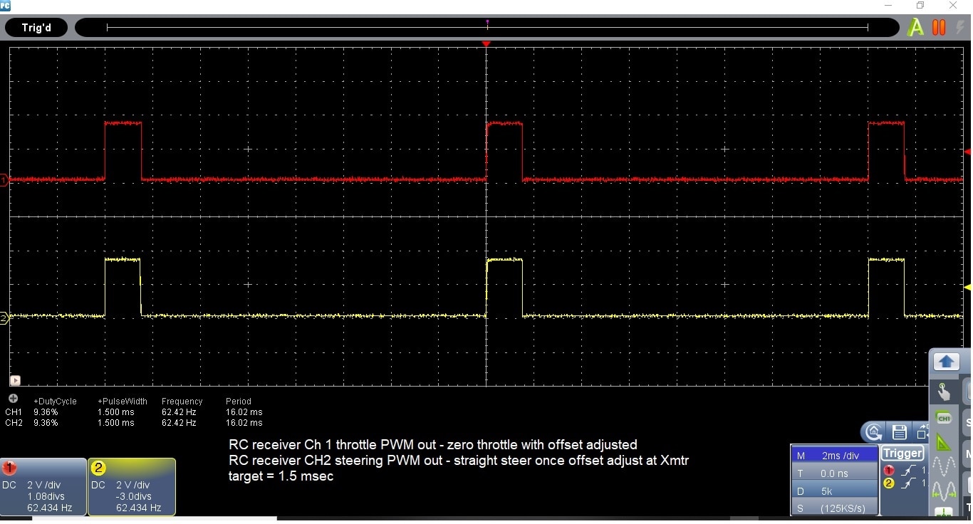

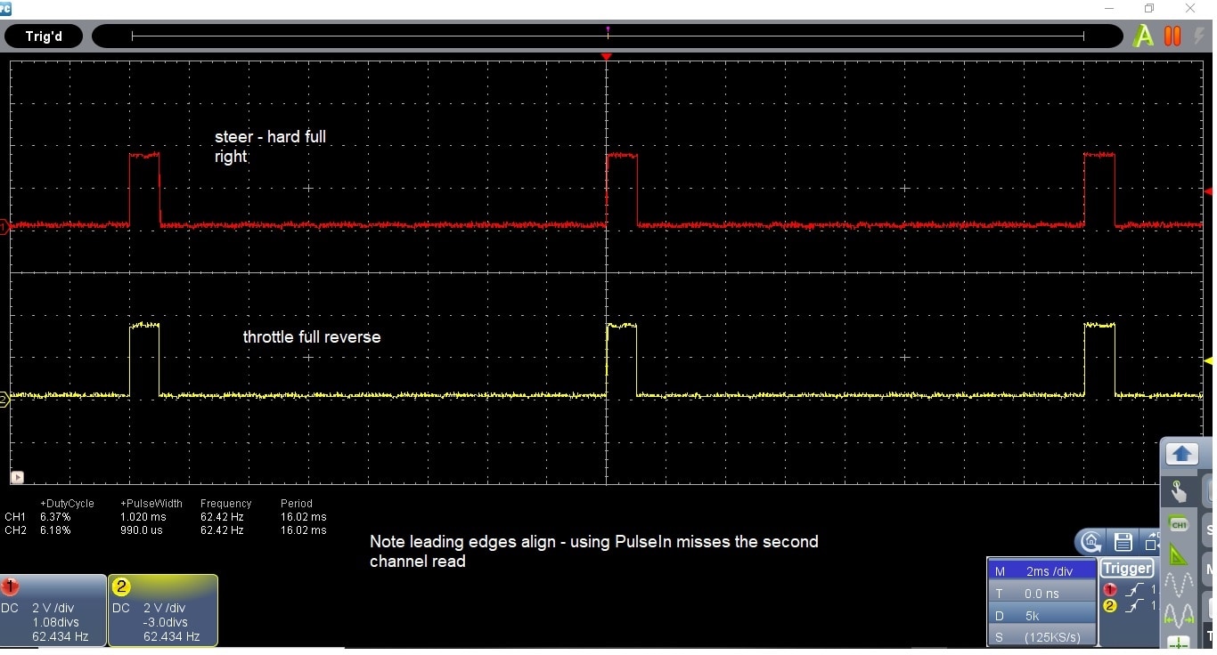

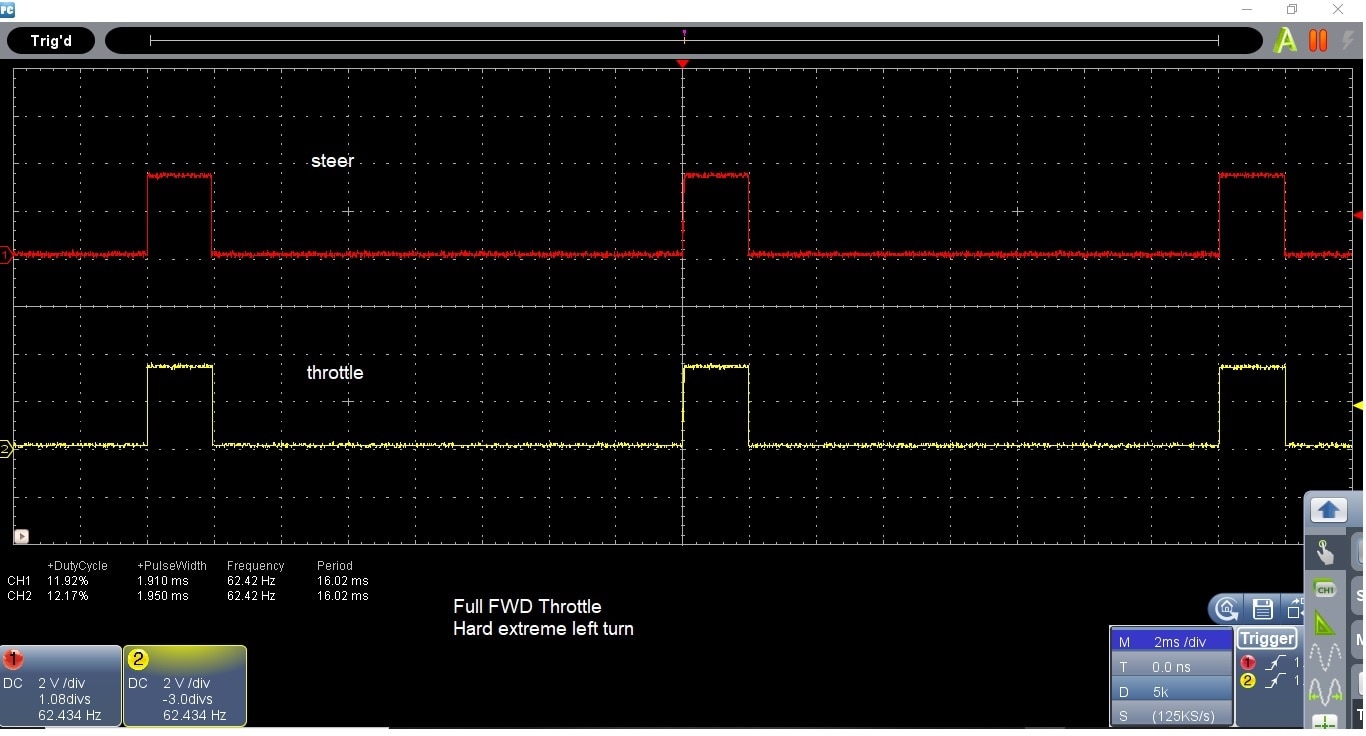

3. screen shots of the scope timing of the FS_GR3E radio receiver PWM output timing

3. The screen shots show why separate Arduinos were used for propulsion and steering. image

    robogary over 4 years ago in reply to amgalbu
    Externally, an oscilloscope was used.
    In the Arduino code:
    CH1_PWMtime = pulseIn(6, HIGH, timeout); // pulseIn(pin, value, timeout) value is HIGH or LOW, timeout and value are long int
    There are consequences to using this function. It seems to wait for the pulse to go HIGH and no other code is executed during the wait. The function is independent of an interrupt pin. It can interfere with other executing functions unpredictably.  I've blamed it for weird bad data issues when running with i2c bus on the propulsion Arduino controller.
    This is the first time I've used the pulseIn function with IO busses.
    If I have time to improve, I'd like to move this PWM measurement to an interrupt pin and hard code the pulse width measurement to see if it it helps solve i2c misreads.
