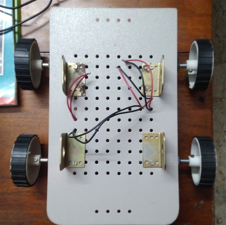

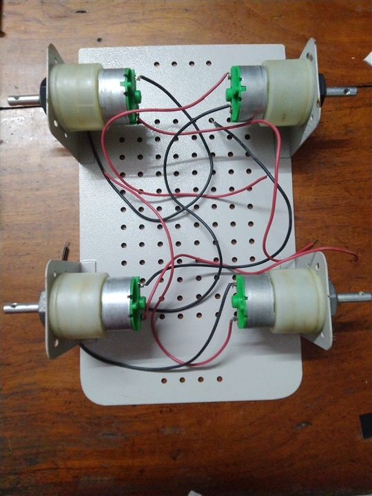

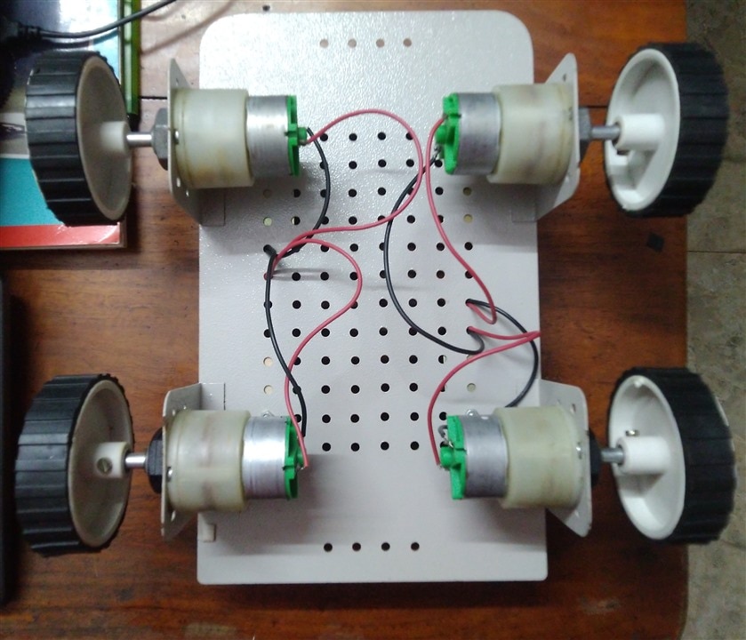

1. The Main Robot Body
I am using a Steel chassis with 4 x 100 RPM - 12V Centre Shaft DC Geared Motors and 4 x 7cm Diameter wheels.
image    image    image
