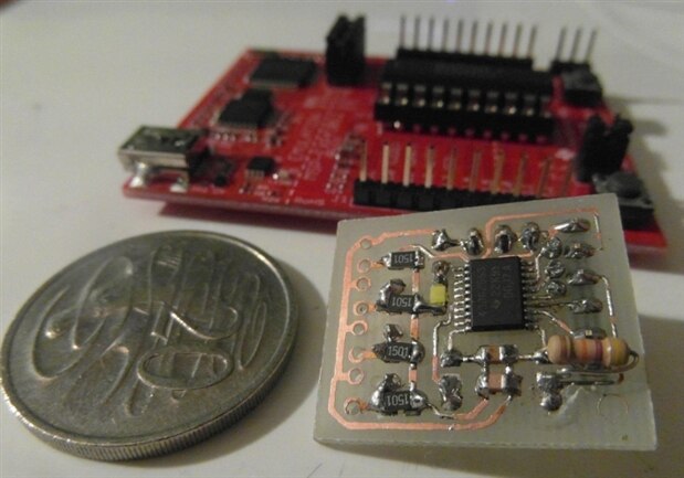

Launchpad Mini

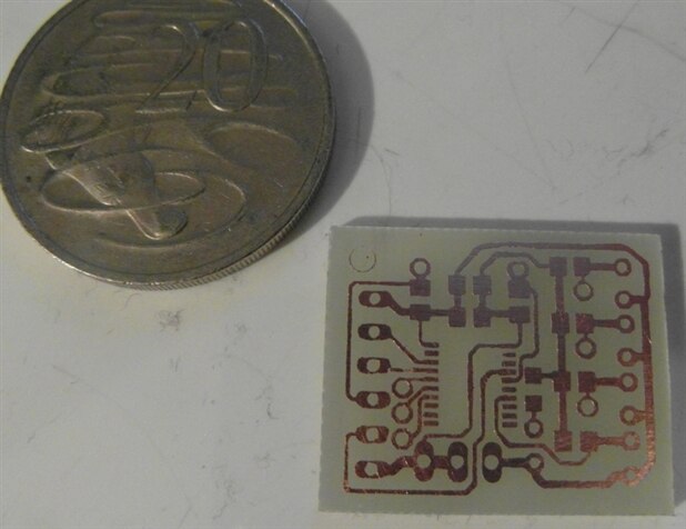

So as part of my clever containers I designed a mini launchpad board sporting the MSP430G2553. I managed to fab it up using the toner transfer method, this is by far the smallest board I have made with this method, it is not the neatest soldering job but it works a treat..
I did have quite a bit of trouble initially actually, I very stupidly soldered a 47Ohm rather than a 47kOhm as the reset pullup resistor, I wont tell you how long it took me to find this mistake..

    Just wait until you get as old as I am and have to use a magnifier just to see the bands on the resisters. image
    Getting a reliable power on reset is essential to any embedded project.
    How did you get the SMD's soldered on the board.  I am not sure that my hands are steady enough to work on things that small.
