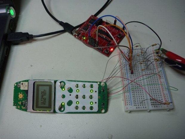

Whilst eagerly waiting for the delivery of the CC3000, I have been taking this opportunity to read the associated literature and to watch the demonstration videos.
It's also a good opportunity to start familiarising myself with the tools such as Code Composer and EAGLE.
I've never used EAGLE before except for viewing an existing design.
I downloaded the latest version V6.1 and currently running in freeware mode until I have become more familiar with it.
I have started laying out my first PCB.
I've defined the board outline to the max 3.9in x 3.2in. - To me this was an unusual procedure. I've never used wires to define a board outline.
Then placed the RHA footprint for the MSP430FR573x microcontroller.
I was very happy to find tht the RHA footprint was in the Texas library because it saves me the time and effort of having to create my own library component.
Now, how do I....?
I just started my first schematic.
Poop! I spoke to soon. There's no MSP430FR573x/2x component in it. I will have to create my own library component or source it from elsewhere.
April Fool's Day
"LaunchPad preparations"
I opened up my MSP430 LaunchPad hoping that I can use it for preparing for the arrival of the CC3000 and MSP430FRAM kit.
I took this opportunity to use the CCS (Code Composer Studio v5) and MSP430ware for the first time.
To ensure that the process worked properly I used the blank MSP430G2211 that came with the LaunchPad.
I must say that it was very easy to use.  The "Hello World" application for microcontrollers (i.e. Blinking a LED) was up and going within minutes.
All I did use the Resource manager, look through the MSP430ware folder and select the Blink LED example.
I did a build, invoked the debugger which loaded the microcode and pressed F8 to get it going.
I also used the debugger to single step through the code.
After that I manually created my own project to blink a LED to find that it was just as simple to accomplish.
I don't know whether it is applicable but no initialisation was required on my behalf except of the disabling of the Watchdog timer since I wasn't using it.

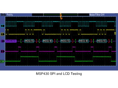

To confirm at its working I observed the output waveform on my MSO and also I hooked up an LED and 390 ohm resistor between P1.2 and GND and observed its behaviour to the signal.

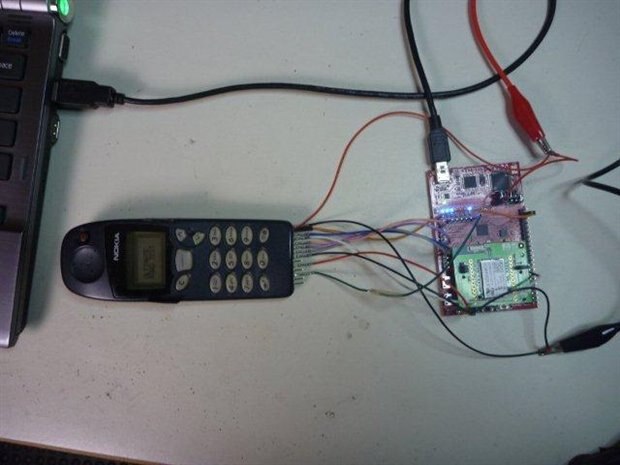

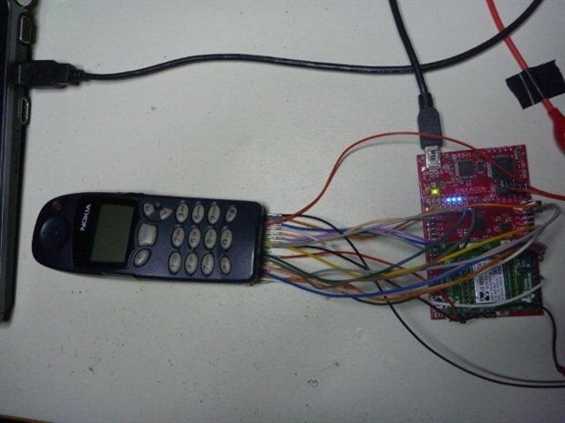

6th April

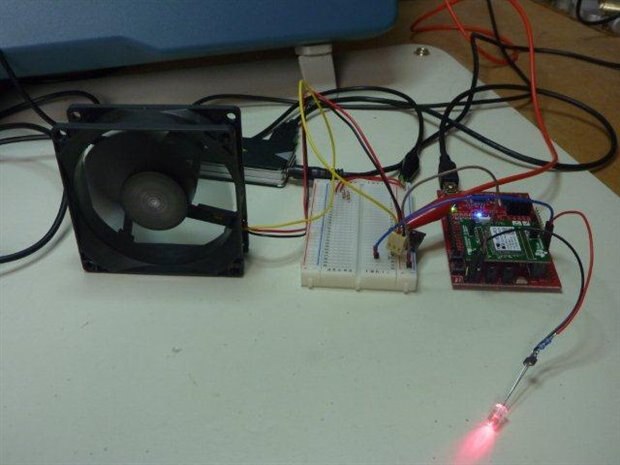

I've lost a day somewhere or other. Anyway I've made some additional progress. Using the HA Sample as a start, I've started adding some bits to it.
I've now got it working with a fan as well.
The MSP430 output pins can't handle the power requirements of the fan so a logic level MOSFET was used.
During my research I did notice some commentary errors in the sample code. These are minor and should be ignored.
Now all for major criteria have been completed:
    Wireless - WLAN
    Sensing - Temperature Readings from Thermistor
    Lighting Technologies - Dimmable LEDS
    Motor Control - The connection of a fan and a minor addition to the HA app.
However I don't think this would impress the judges but it does show that I have some sort of idea of what's going on.
Out of the box SimpleLink WiFi CC3000 is most impressive!

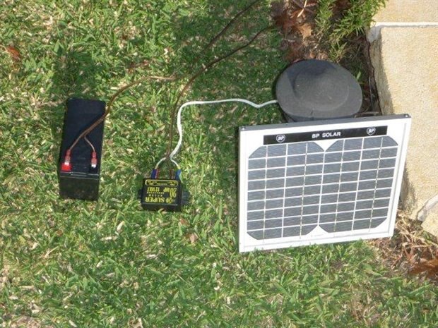

Energy Supply
Today I've rigged up a small solar panel,regulator and 12V SLA battery as a potential power power supply.
With a nice bright sunny day like today I was able to get about 200mA @ 14V to the battery to charge it.
The raw voltage level of the panel varied from around 16-20V. The regulator limits this to a max of 14V.
This is more than overkill for this application but it's a starting point.

To get the LCD screen working I must get the SPI interface working.
With the aid of my LaunchPad and 430Ware to the rescue, it didn't take too long to get something up and running.
Pictured here is my attempt at generating the required signals.
Trace 2 SCLK (CPOL is irrelevant)
Trace 1 Data
Trace 3 -CS
Trace 4 Command/Data selection
There's also a -RESET pin that's driven and MISO signal but they're not shown above.
I've set the MSO to decode the data stream to confirm that it is correct.

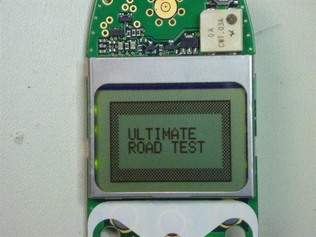

11th April
"Getting high on LCD"
I've got the LCD working and have written a small driver to enable it to display some text and graphics.
Being a Graphic LCD, the host (MSP430) needs to generate the fonts and graphics. This all needs to be stored in the host's memory.
The functions written are:
drawLCDchar()
drawLCDstring()
These use a 5x7 font I created specfically for the LCD.
In addition to the abovementioned character functions, bit mapped graphics can be directly dumped to the LCD.
With the LCD working I can now get direct visual feedback from the MSP430.
Here's a picture of the setup. I am currently using some signal voltage dividers to down convert 3.6V to 3.3V logic levels.
These can be omitted later (by using VDD=3.3V).

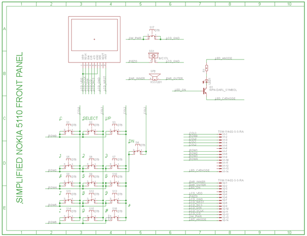

"The EAGLE has landed - Part 2"
I have learned to use the EAGLE schematic capture to document the Nokia Front Panel connections. The procedure was foreign to me but once I got the jist of it it made sense. A bit like a German car where a lit LED indicates an off condition and the indicator stalk on the wrong side. I had quite a few occasions where I turned on the windscreen wipers by accident.

"Live Organ Transplants"
This is just a picture to show that the work done on the Launchpad has been transplanted to the Fraunchpad and all is operational.
15th April
"Spreading your tentacles"
Look at all the wires now! Wow just so many!
The keypad has been fully connected up and is operational.
